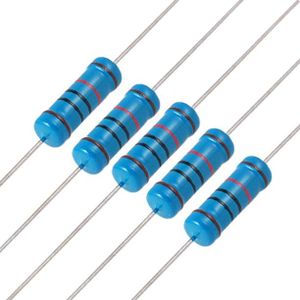

I modified to change the buttons into jumper wires connected to 10k ohm resistors, then change the code of pin 16 to pin 11, pin 14 to pin 12, and made it accessible to everyone who doesn't have the add-on board.

- 6 10k Ohm resistors

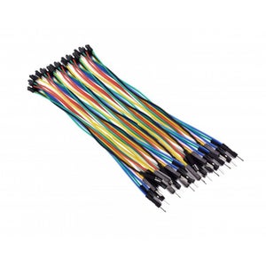

- 32 jumper wires

Set up the wires by this picture above, use the second image for reference.
