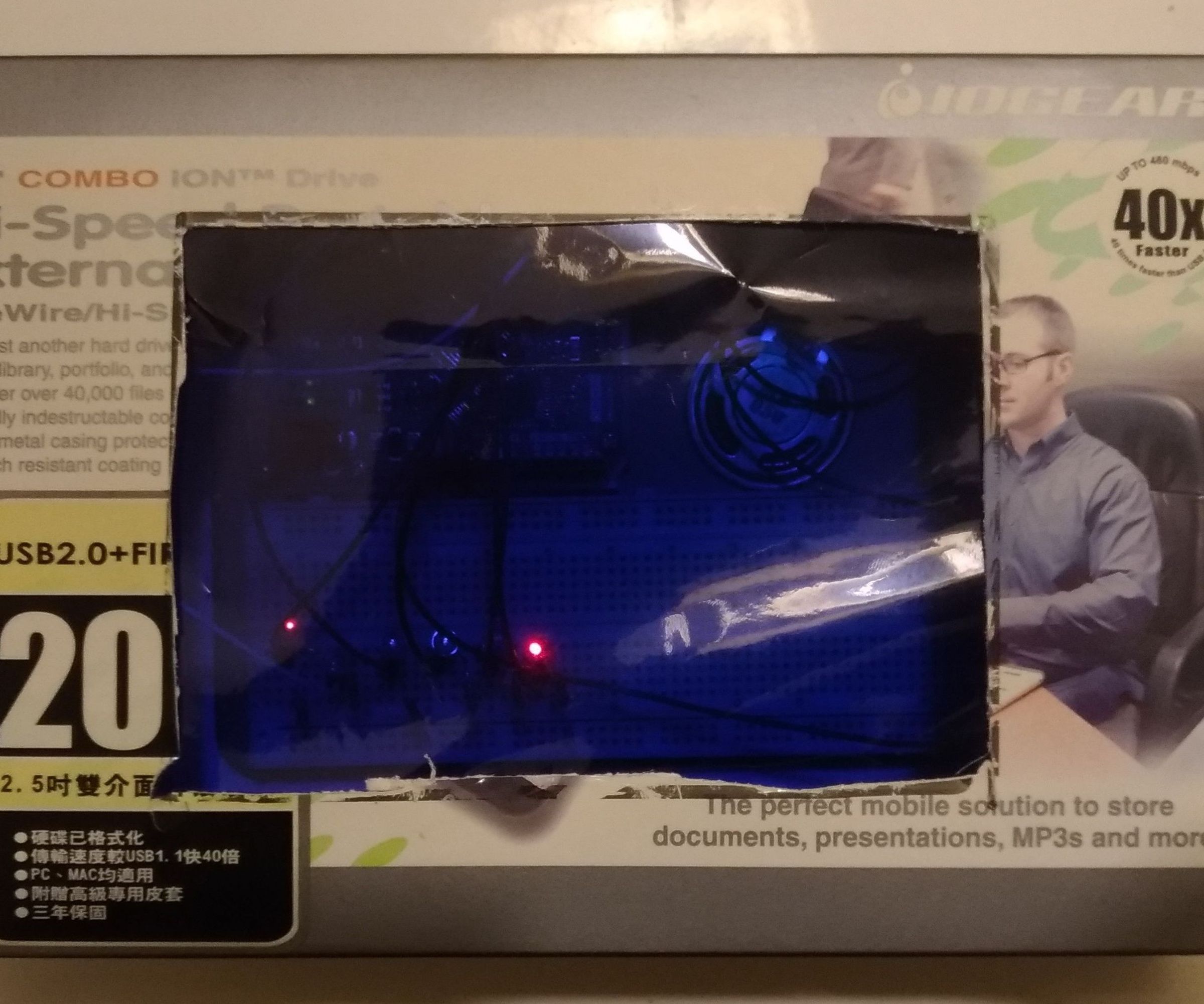

Step 1: Connect the LCD/controls
For the LCD, the first two wires (yellow and orange ) should be connected to the top left of the breadboard, as shown in the picture. The other two wires (red and brown) should be connected to the SDA and SCL respectively.
Connect two of the push buttons to the Arduino. Connect the first wire to the first button, this will be the start/reset button. Connect the other side of the cable to the 8 pin on the board. Do the same for the other button but connect the other wire to pin 9 on the Arduino. Next connect both buttons to ground making sure to use 2 of the 4 resistors to prevent too much voltage. (use the pictures as a guide)
Step 2: Design the Code
You can get the code from the link provided too:
https://create.arduino.cc/editor/tedchou621/b9c77352-5700-447e-96b5-3329fbf25f4b/preview
Step 3: Yeah I Think You're Done
The cardboard box is optional, and if you've done everything correctly, the left button should function as the start/reset button, and the right button should function as the pause button.
