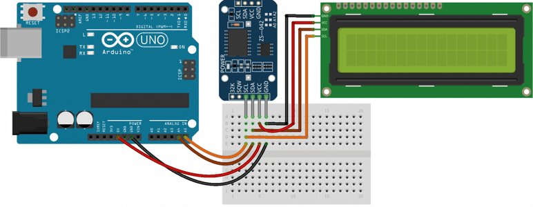

Step 1: Wire the LCD and the Clock Module
Wire the LCD and clock module as presented on the photo. Make sure you do this with the arduino UNO, with other arduino's the wiring is different.
Step 2: USE the Following Code
This is the code you need to install the lcd and have the same text on it.

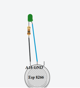

Step 6: The Wiring
For these steps you will need :
-1 ESP 8266 HUSSAH feather (+drivers)
-1 Led
-1 100-ohm Resistor
-2 Female/Male wires
-USB cable (B)
Connect the wires to the led the short leg needs to be negative (GND) and the long one positive (A16) and upload the following code "stemproject" Don't forget to change the necessities in "arduino_sectrets.h"
Download MQTT Explorer and select your server. Change the server in the code.
When the board is connected to the server you can try to send a 0 or a 1 message
If the bytes come thru your led will light up

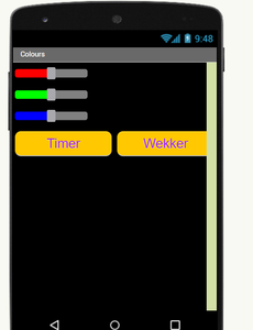

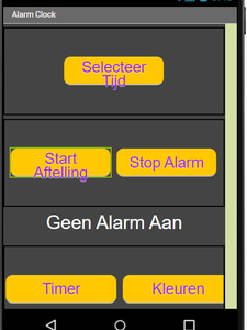

Step 7: The APP
Download the app code and import it into MIT app inventor and download the necessary companion app on your phone FYI, the newest is the best but crashes a lot and Android phones are slightly better
The first screen is the main menu, here you can start and stop your alarm
The second screen is your led light slider

IMPORTANT NOTE: Do not close the app when it's running to avoid canceling your clock module
https://github.com/JJVanC/Alarmclock
