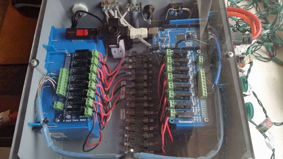

Step 6: Hardware
The arduino: Keep in mind that when using the arduino with vixen that the channels will be off by 2. Example channel 1 in vixen will operate pin 2 on the arduino. This is due to the fact that pin 0 and pin 1 is a TX RX and will not work with this set up. It's best to make a note to put with the equipment so that you will remember this.
There are some choices on hardware. I chose the most simple option to get started. A regular relay board I built. The only down fall is it's just a on/off option. Vixen can do fading but this will require a more advanced relay board. This may be in my future and will add info here when ready.
You can see my relay board layout on my other instructable. The arduino sends the on off signal to each relay that in turn will make the lights go BLINKY BLINKY.
I used the same method but a more narrow board so I could fit it the the box I chose. I used and orbit outdoor sprinkler timer box. It's rigid and the size I needed.

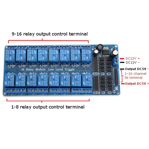

Reply 5 years ago
I bought this from Ebay.
Name"16 Channel 5V Relay Module Board Optocoupler Power Supply Arduino ARM"
photos
Reply 5 years ago
Make sure that the controller has it's own power supply, the relay board has it's own power supply. Make sure to connect a ground wire from the Arduino negative to the relay board negative. If this doesn't solve the problem you might have to consider different relays (non machinical type) like a solid state. Like this one .https://www.sainsmart.com/products/8-channel-5v-solid-state-relay-module?utm_medium=cpc&utm_source=googlepla&variant=45099713876&gclid=CjwKCAiA07PRBRBJEiwAS20SIEW_PjDp_BpU45tOkjJ8uj_-61HejF4LMvHi-hC34_OueDK56FuD5BoClCoQAvD_BwE I have a feeling that the relay board being generic may not be suitable for the high voltage even though the relay it self is rated for that. I feel it could be voltage flyback in the circuit causing the Arduino freeze.
