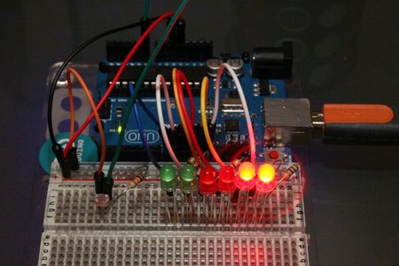

This is a project for Arduino to make a Light Sensitive Bar Graph, aimed at beginners.
Arduino measures the voltage on a voltage divider composed of a resistor and an LDR (light dependant resistor).
A bar of LEDs are illuminated corresponding to the measured voltage.

Step 2: Wire It Up
Wire up the circuit as shown in the diagrams.

Step 5: Enjoy
Try changing it to "decay" the bar graph using:
decay = max(sensorValue, decay);
and reducing decay each iteration.
