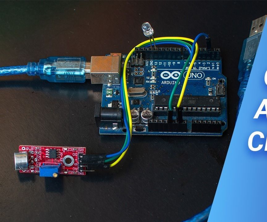

Step 2: The Circut
In the picture the LED's negative is connected to the ground of the Arduino and positive to digital pin 13 of the Arduino.The LDR's one pin is connected to 5V of the Arduino and second pin is connected to A0 of the Arduino and there is a resistor connected to the second pin of the LDR and then the resistor is connected to ground.Check your circut carefully or the Arduino might burn up.
