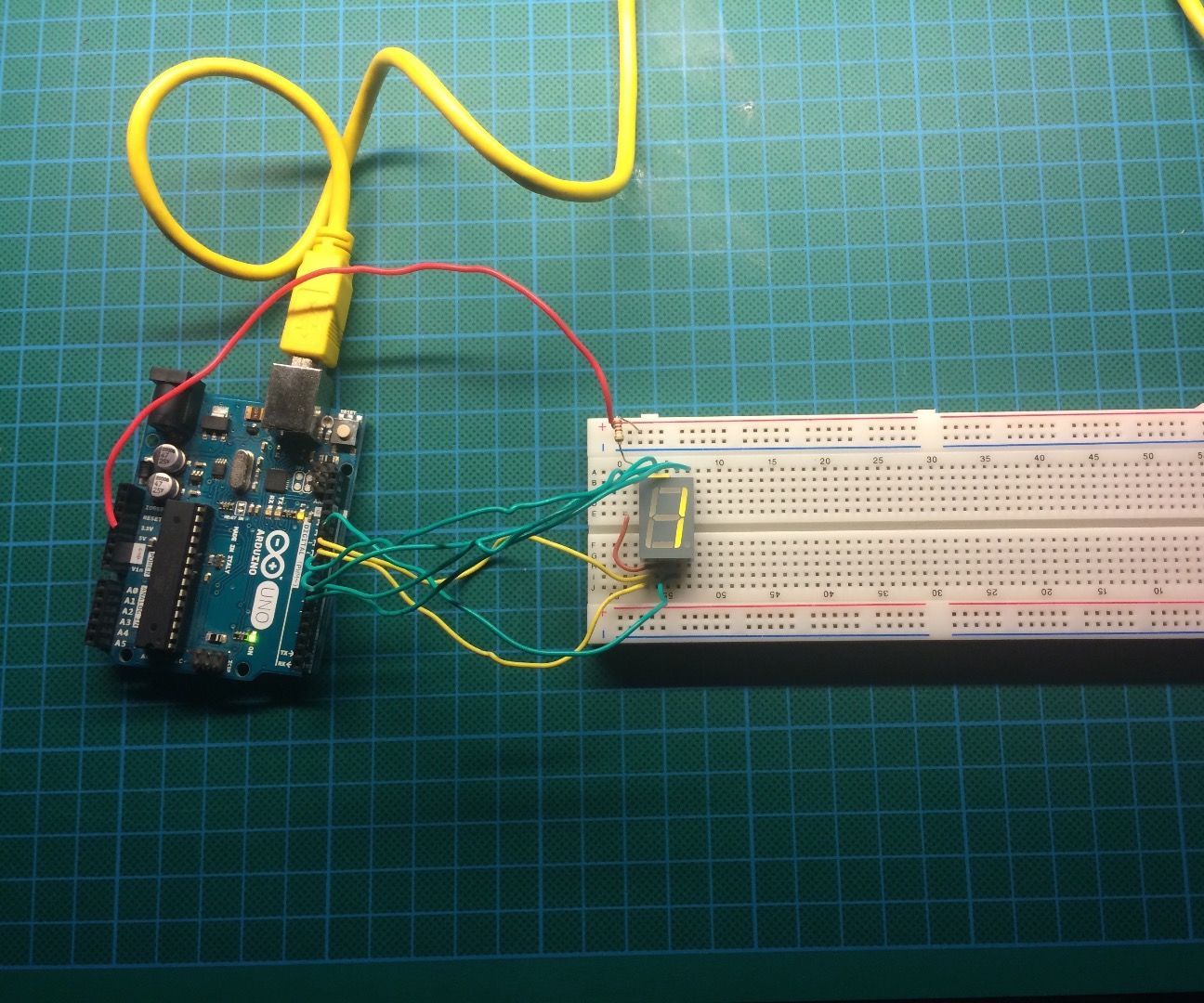

Step 2: Giving Power to Our Breadboard
Ok the first step simple is really simple. Using 2 jumper wires connect the 5V pin to the positive power bus on your breadboard and the GND pin to the negative power bus, just as shown in the picture above.
Step 3: Connecting the Resistors
Ok now in this step we are going to wire up the photoresistor with the A0 analog in pin. First of all connect the photoresistor with the positive charge and then put the 10KΩ resistor in series and connect it with the negative charge. Finally connect A0 analog in pin with the photoresistor as shown in the image above.
Step 4: Wiring Up the LED
In this step we are going to add the LED on our circuit. The first thing we want to do is connect the anode of the LED with the 220Ω resistor and then the resistor to digital pin 2 on the board of the Arduino. Lastly connect the LED's cathode to the negative power bus. You should end up with something that looks like the circuit in the image above. That's it, we have finished building the circuit. Now it is time for us to write some code !
