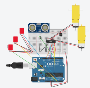

Step 1: Arduino Code + Wiring Diagram
The circuit(s) for all components are wired as shown. Note that the motor controller shown in the schematic is a generic H-bridge chip, not the Sparkfun motor controller board. More information for wiring this breakout board can be found on the Sparkfun website. In this schematic, pins 6-13 are used as digital I/O and analog pins A0-A2 are used to read the various sensors. The 5V battery pack that powers the arduino is not shown.

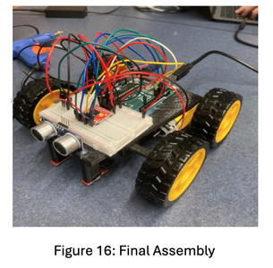

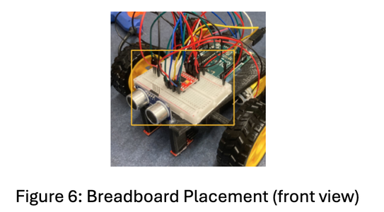

The assembly for this vehicle is straightforward, as the chassis only involves two components: the main body and the non-drive wheels’ axle. All components are hot glued or press fit onto their respective parts in the locations shown in figures 5-14.
In figure two, the 3D printed main body of the chassis already has all the necessary mounting locations for the line sensors and the non-driven wheels’ axle. The line sensor “nubs” ensure that the sensors sit as close to the ground as possible for accurate line reading.
Upon completion of steps 5-14, your final vehicle should look something like this. Ensure that the line sensors are low enough to the ground to easily detect a black line on a white surface (you can test this with a marker on a piece of paper). The ultrasonic distance sensor should be mounted as perpendicular to the main body of the chassis as possible for accurate distance readings. For the IR sensor, the placement is not directionally sensitive, simply make sure it doesn’t become too tangled up with the wiring.
