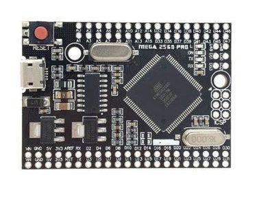

  • 1 Arduino Mega 2560 Pro

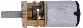

  • 2 DC motor 600rpm and bracket

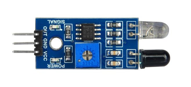

  • 1 Infrared obstacle sensor

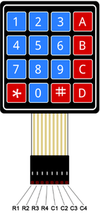

Step 2: DIY Keypad Shield
To make keypad shield I found this tutorial "How to read a 4x4 keypad using just one Arduino pin!" https://shorturl.at/ciN07
Bill of material:
  • 1 Double side prototype PCB
  • 3 Resistor 1.5K ohm
  • 4 Resistor 390 ohm
  • 1 Resistor 4.7K ohm
  • 1 Capacitor 0.01 uF
Here is a short video of me using the keypad shield https://shorturl.at/zAV01 and https://shorturl.at/itKPS

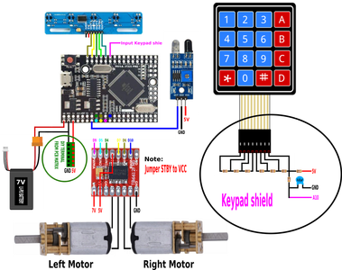

Step 3: Schema

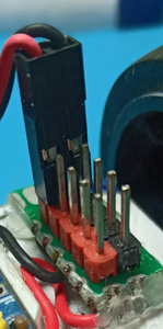

In this schematic you will find the "DIY Terminal". Made of multiple male header pins and a double sided PCB prototype. Used to supply 5V power for line sensors, keypads, driver motor and infrared obstacle avoidance sensor.

Read keypad:
Look at the picture, when button 2 of the keypad is pressed the value 151 appears.
int readKeypad(){
  int value = analogRead(A10);
  Serial.println(value);
  if(value == 208){ //Button value 1
    mode = 1; //The robot moves to the first place
  if(value == 151){ //Button value 2
    mode = 2; //The robot moves to the second place
  if(value == 84){ //Button value 3
    mode = 3; //The robot moves to the third place
  if(value == 5){ //Button value A
    mode  = 4; //Back to base
    return mode;

The robot stops at the destination until the infrared obstacle avoidance sensor enters a low state and then moves back to the base.
