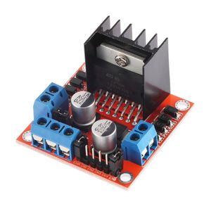

  • LN298N DC Motor Driver

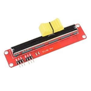

  • Potentiometer module

  • Connect digital pin(6) from Arduino to motor driver pin (IN1)
  • Connect digital pin(8) from Arduino to motor driver pin (IN2)
  • Connect Linear Actuator to the motor driver as you can see on the schematic
  • Connect potentiometer pin [DTA] to arduino analog pin [A0]
  • Connect potentiometer pin [VCC] to the breadboard positive pin [5V]
  • Connect potentiometer pin [GND] to the breadboard pin [GND]

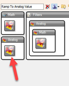

Step 4: Start Visuino, and Select the Arduino UNO Board Type
Start Visuino as shown in the first picture Click on the "Tools" button on the Arduino component (Picture 1) in Visuino When the dialog appears, select "Arduino UNO" as shown on Picture 2
Step 5: In Visuino Add Components
  • Add "Dual DC Motor Driver Digital and PWM Pins Bridge (L9110S, L298N)" component
  • Add "Ramp To Analog Value" component
Step 6: In Visuino Connect Components
  • Connect Arduino Analog pin [0] to "RampToValue1" pin [In]
  • Connect "RampToValue1" pin [Out] to "DualMotorDriver1" > Motors [0] Pin [In]
  • Connect "DualMotorDriver1" > Motors [0] Pin [Direction]" to Arduino digital pin[8]
  • Connect "DualMotorDriver1" > Motors [0] Pin [Speed]" to Arduino digital pin Analog PWM[6]

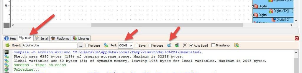

Step 7: Generate, Compile, and Upload the Arduino Code
In Visuino, at the bottom click on the "Build" Tab, make sure the correct port is selected, then click on the "Compile/Build and Upload" button.
