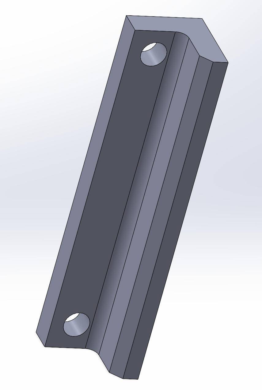

Step 1: Create the Basic Design
Use CAD software (like SolidWorks) to create a basic idea of what you want the safe to look like. Be sure to take into account functionality and additional attachments that will be added later. Our basic design was made with laser-cut wood and 3D printing technology; however, this can be any material you like. Be sure the final design has these properties:
  1. Drop-resistant
  2. Unable to access from outside the safe
Step 2: Design All Necessary Parts & Collect Materials
You will be creating your own safe, and your next step is to design your parts using CAD software, like SolidWorks. This will provide a visual of what you will be constructing. If you do not have access to CAD software, you can try sketching your idea by hand, but this is not the most practical or effective method. Then, begin collecting the materials and parts required to make your safe. In the Materials section, we list the components that go into constructing the safe. Be sure to get what you need before beginning assembly.
Step 3: 3D Print the Parts
If you are using a 3D printer, you will first need to upload your STL file into a software application, such as Cura. The STL file contains all the required information to enable the printer to print your parts. Then, the 3D printer prints the individual parts for your safe.

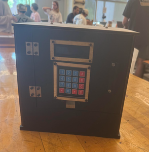

Step 6: Assemble Safe & Parts
If using the Arduino-based version of this locking safe, ensure your Arduino is powered on with the green light present. This is usually achieved with the Arduino connected to the USB port of the computer. Then, assemble the locking safe by adding all of the components. Once the safe is assembled, you can test its functionality by attempting to open and close the safe multiple times. You can also test the locking mechanism by inserting the correct password and seeing if the lock unlocks the safe.
Step 7: Upload Your Code
Upload the correct code and ensure that it runs smoothly before sending it to your car as a final product. Function check and test all controls before finalizing your code! This was the code that we used for our safe!
Step 8: Lock Away Your Valuables!
Finally! Your locking safe is now finished! We tested each part and functionality to make sure the final product works. So, insert your valuables and enjoy your new Arduino locking safe!
