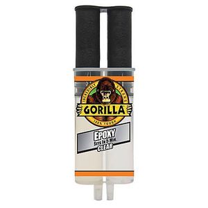

Step 3: Strengthening the Box
Next, we had to make the box solid. To do this we used Gorilla Epoxy.
  1. Firmly tape the box
  2. Mix epoxy and apply along all inside edges
  3. Apply to the bottom and outside faces of the corner blocks
  4. Wait to dry
This took a lot more time and patience than expected. Make sure pressure is applied when gluing two sides together. The packaging said it takes around 20 minutes to dry but it took much longer until it felt sturdy enough to remove all the tape.
Even then, it still felt a bit shaky so we added epoxy to the outside corners as well.
Because the fingers on our laser cut box were too short, the edges and corners didn't fit together without tape or glue. The process will be a lot easier and quicker of the fingers of the sides fit flush and snug.

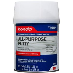

To address the open edges and corners of the box, we decided to use Bondo. Bondo is a strong putty that is applied as a paste and quickly dries to concrete like material where it can be sanded.
To prep the box for the Bondo, painters tape was once again used. This time it just needs to outline the edges so that Bondo doesn't get on the flat wood.
Step 5: Bondo
Once taped, you are ready to apply the Bondo. It is highly recommended that you do this outside with a mask, the Bondo is extremely pungent.
  1. Put Bondo on cardboard
  2. Add activator (50:1 ratio of Bondo to activator is recommended)
  3. This determines how fast it hardens. Too much and it gloops up and is hard to spread. Too little and it takes a long time to dry/harden.
  4. Mix together with a popsicle stick
  5. Apply to the edges of the box
  6. It is easier to remove than go back and add more. Be generous
  7. Once the Bondo has hardened to about the consistency of a rubber eraser, use a utility knife to shave off some of the excess. It is much easier to do this now with a knife for large sections than trying to sand it all later.
  8. Finally, once it is fully dried and hardened, sand down it all down to the level you want. I used 120 grit but something a little rougher helps for sanding larger amounts at the beginning.
  9. Let this air out outside for a while, your house will smell like Bondo if you bring it in immediately.
This takes a decent amount of practice and a lot of patience. We did not get a very clean finish with ours but with more practice and better tools this could look really good if needed.
