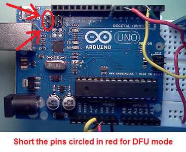

Step 7: Step 7: the MIDI Code
Download and install Atmel Flip. Then, connect the Mega to your computer with the USB and put it into DFU programming mode. This will allow you to program it with Atmel Flip.
Download Atmel Flip from here:
https://www.microchip.com/DevelopmentTools/Product...
Then, download the arduino hex file from here:
https://github.com/ddiakopoulos/hiduino
Upload it to your board via Atmel Flip.
