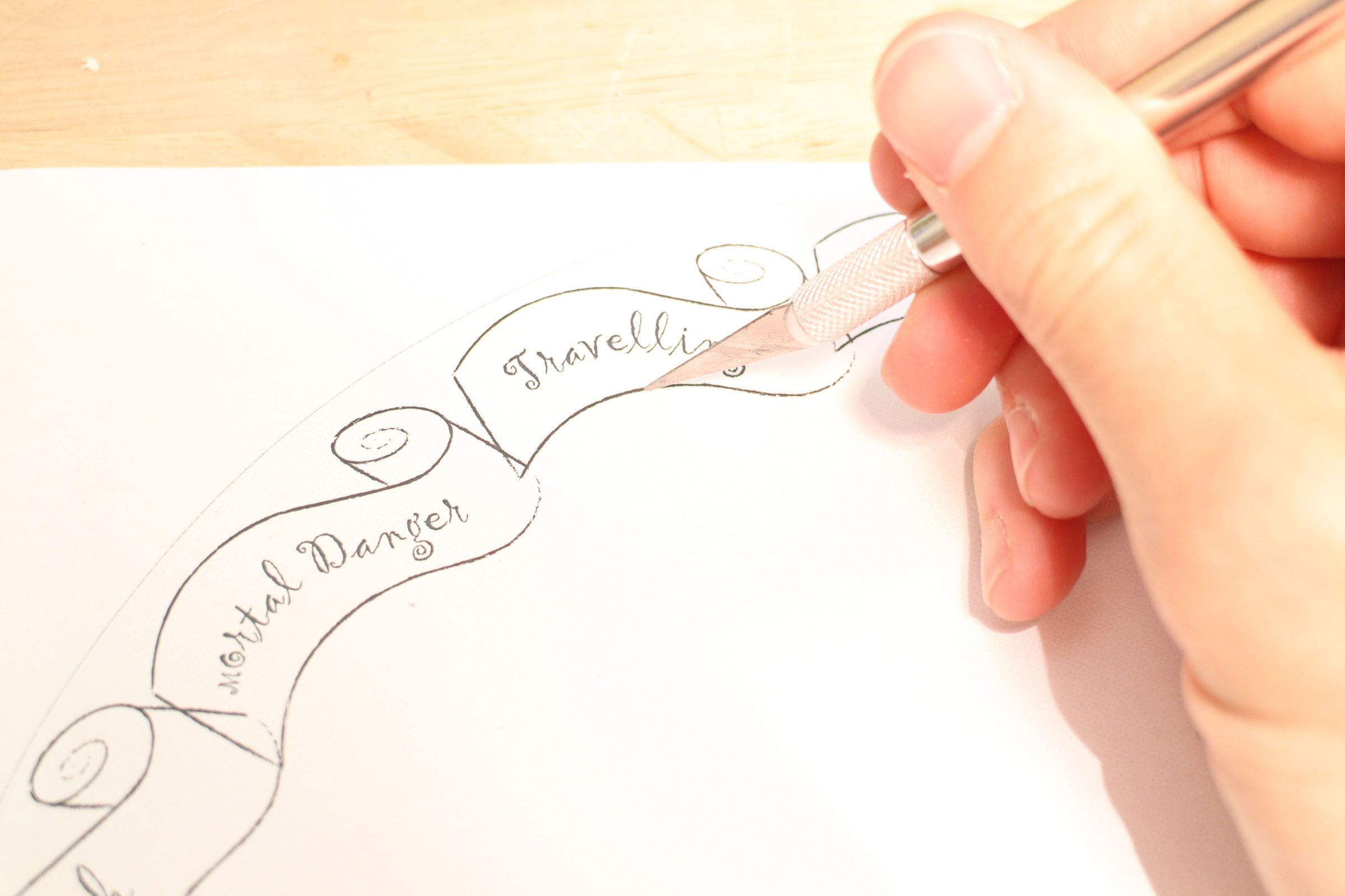

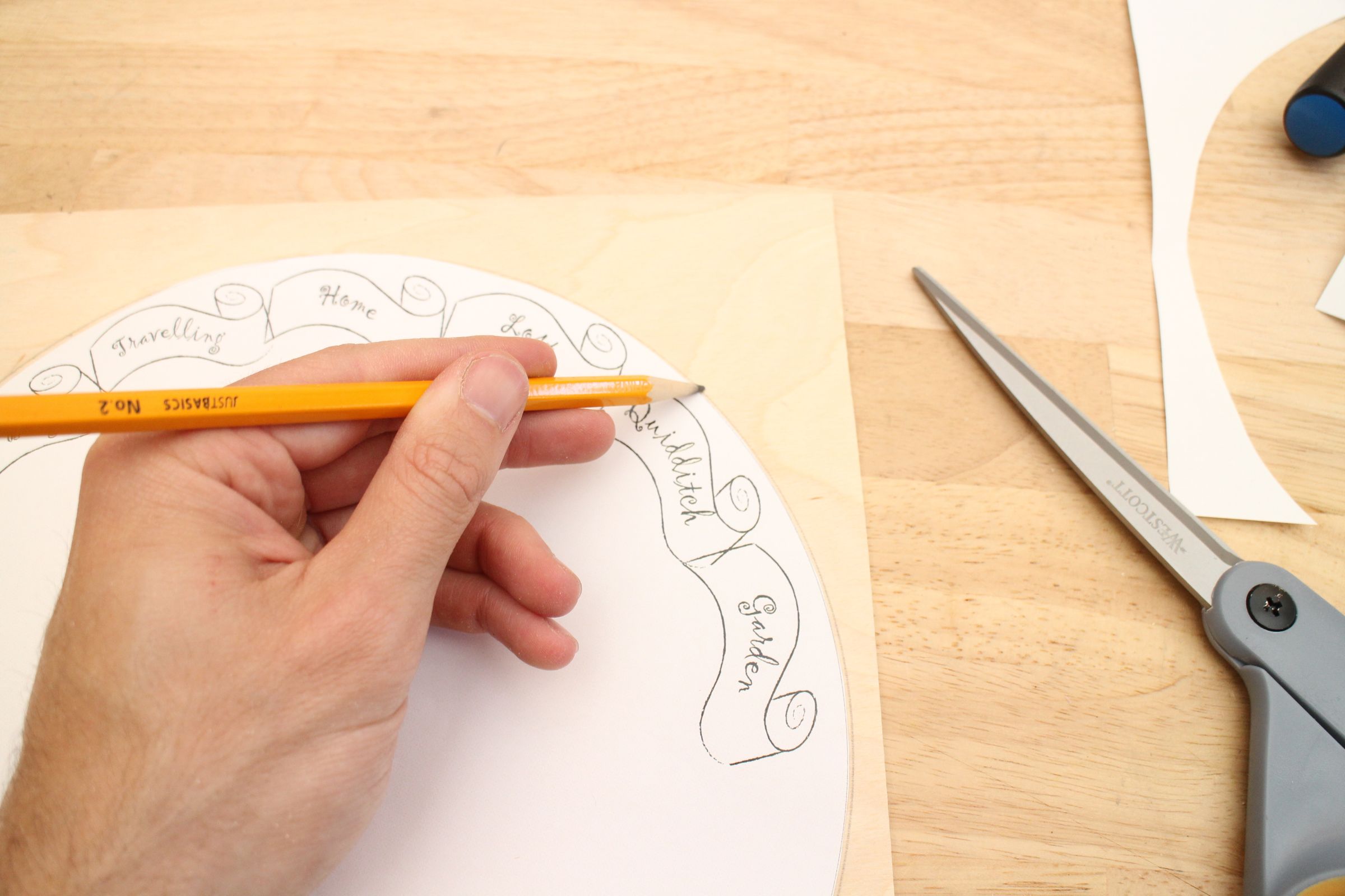

Next, I went about designing my prototype in Illustrator. If you would like to use my template please feel free to download the attached file. I cut out the paper prototype with an Xacto knife and traced the outside circle onto a piece of wood. My clock will have a diameter of about 12 inches. If your printer cannot handle the whole clock face in one go, just tape two halves of the picture together and mark your hole positions.

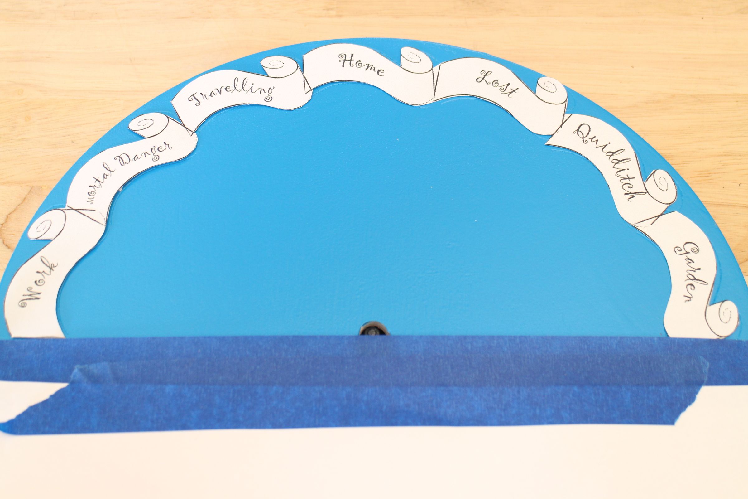

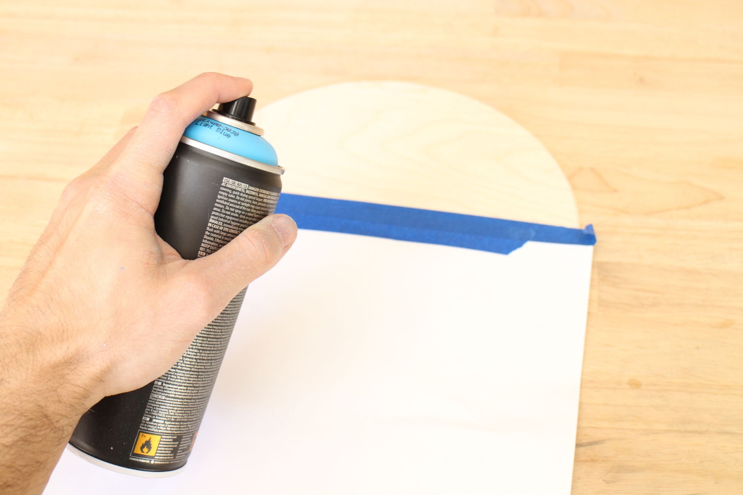

Use an X-acto or saw to cut the outside profile of your clock and a 3/4" drill bit to cut out the holes. I then used painters tape to section of the top half and spray painted it blue. Once it was dry I reversed the tape line and spray painted the bottom half silver. While everything is drying use your X-acto knife to cut out the position locations for your clock.
Step 3: Decorate Clock Face

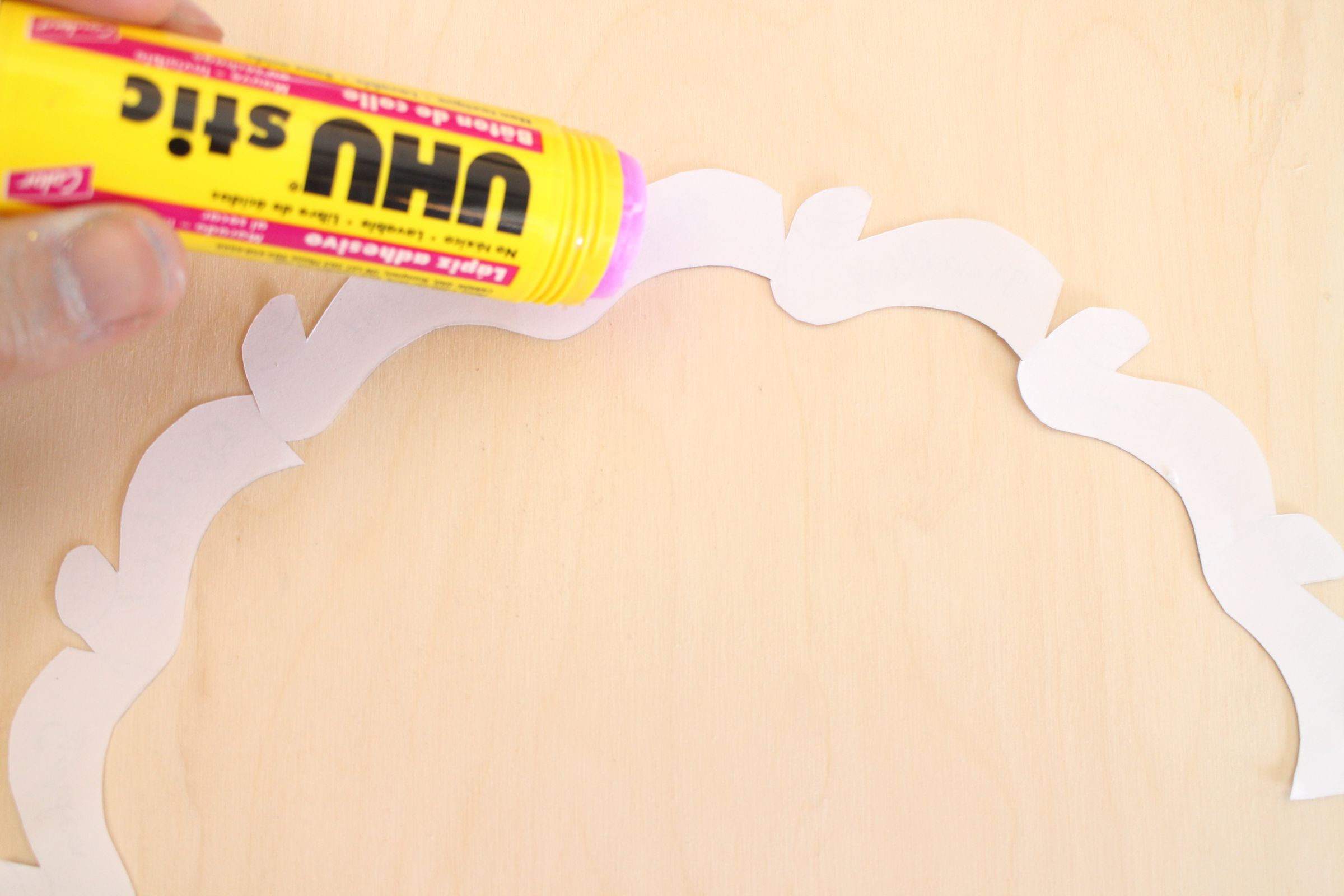

Now that our positions have been cut out, flip them over, rub on some glue, center them onto the face of the clock and press them down.
I may have gotten a bit to fancy at this part, but I thought "you know what would make this clock more magical.....glitter!" So I ran beads of glue around the edges of the clock positions and then sprinkled copious amounts of glitter on top. Once you shake it off it will leave a nice shimmery border around your lettering.

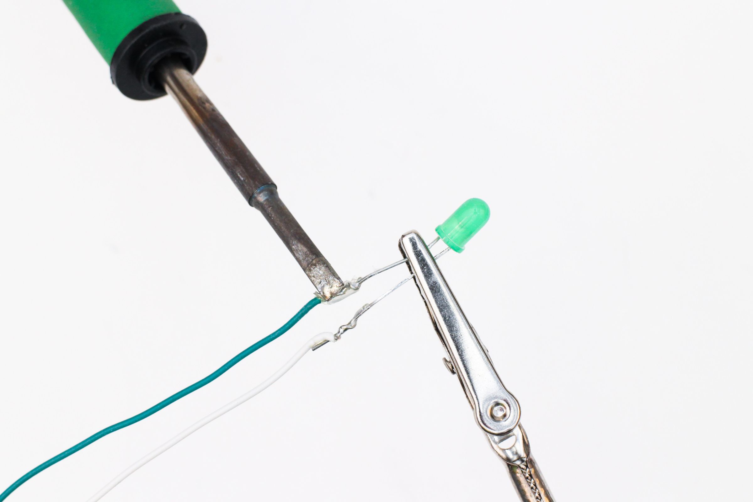

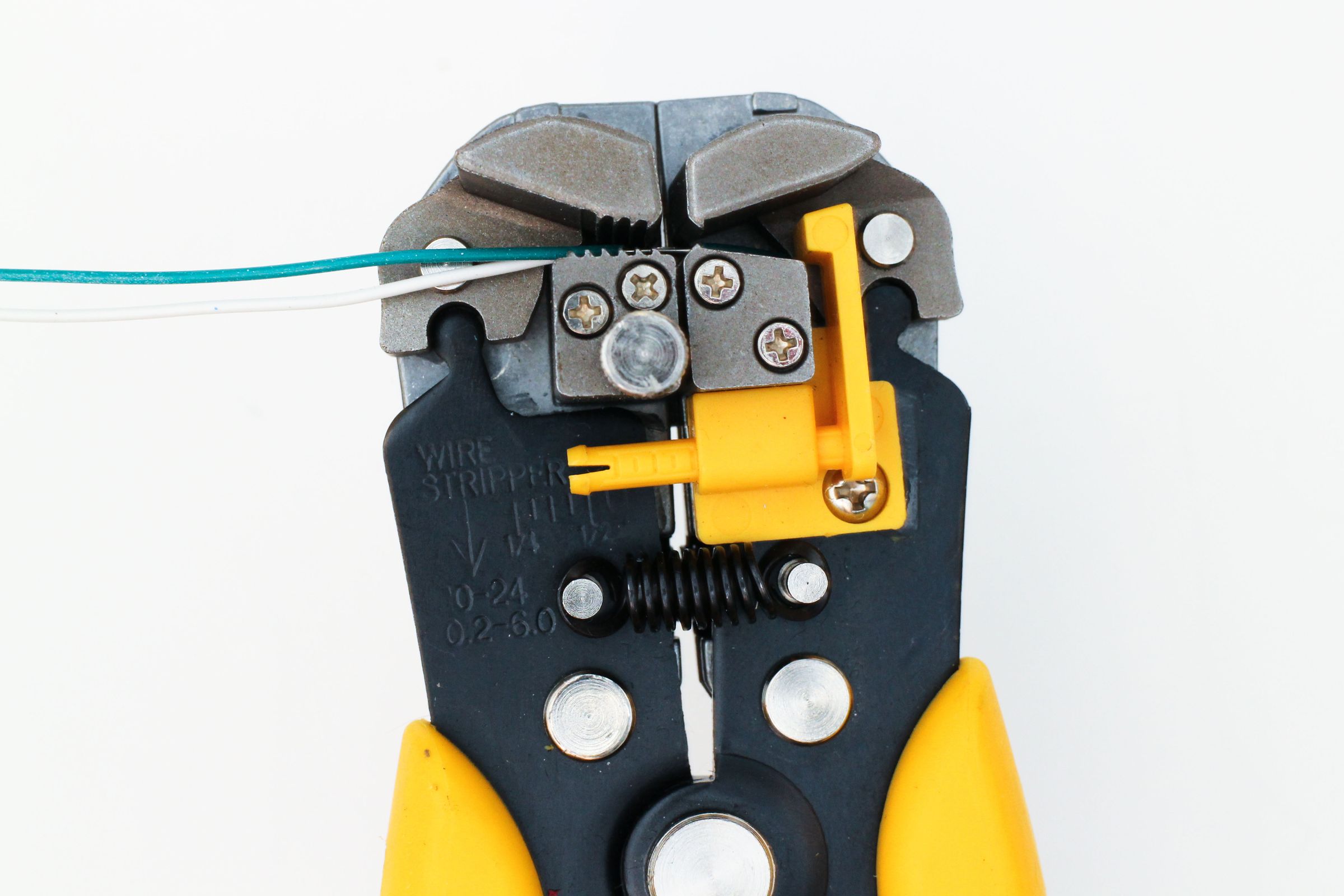

We are going to need to extend the legs of the LED so they can easily plug into our breadboard. To do this we are going to twist the wires together and then electrically connect them with solder. Begin by stripping both ends of the wires with the universal stripper. Next twist the wires together to form a strong mechanical lock, you should be able to lightly tug on the wires without them coming apart. Don't hesitate to use pliers to help get a couple more twists. Then use your iron and solder the wires together.

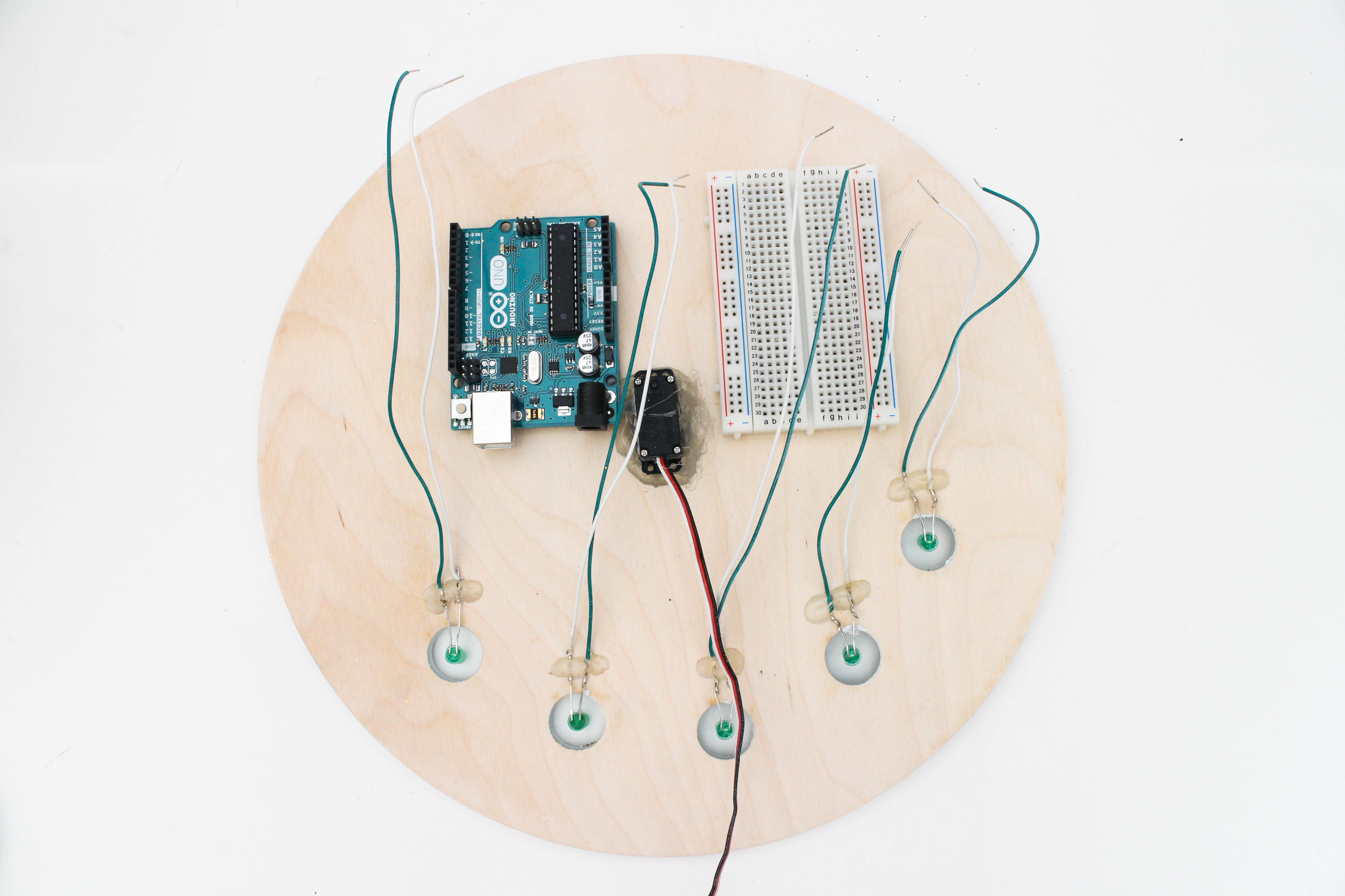

Using double stick tape I fastened down the Arduino and breadboard onto the back of the clock. To begin wiring up the LED's I put all of the ground wires (green wires) into the negative column of the breadboard. Then I plugged in all of the power wires in order into the breadboard.
Step 8: Wiring Up LED's Part 2
Now add another wire from all the positive LED's leads to the Arduino. I used pins 4 through 8 for this, but you can of course use any pins you wish.

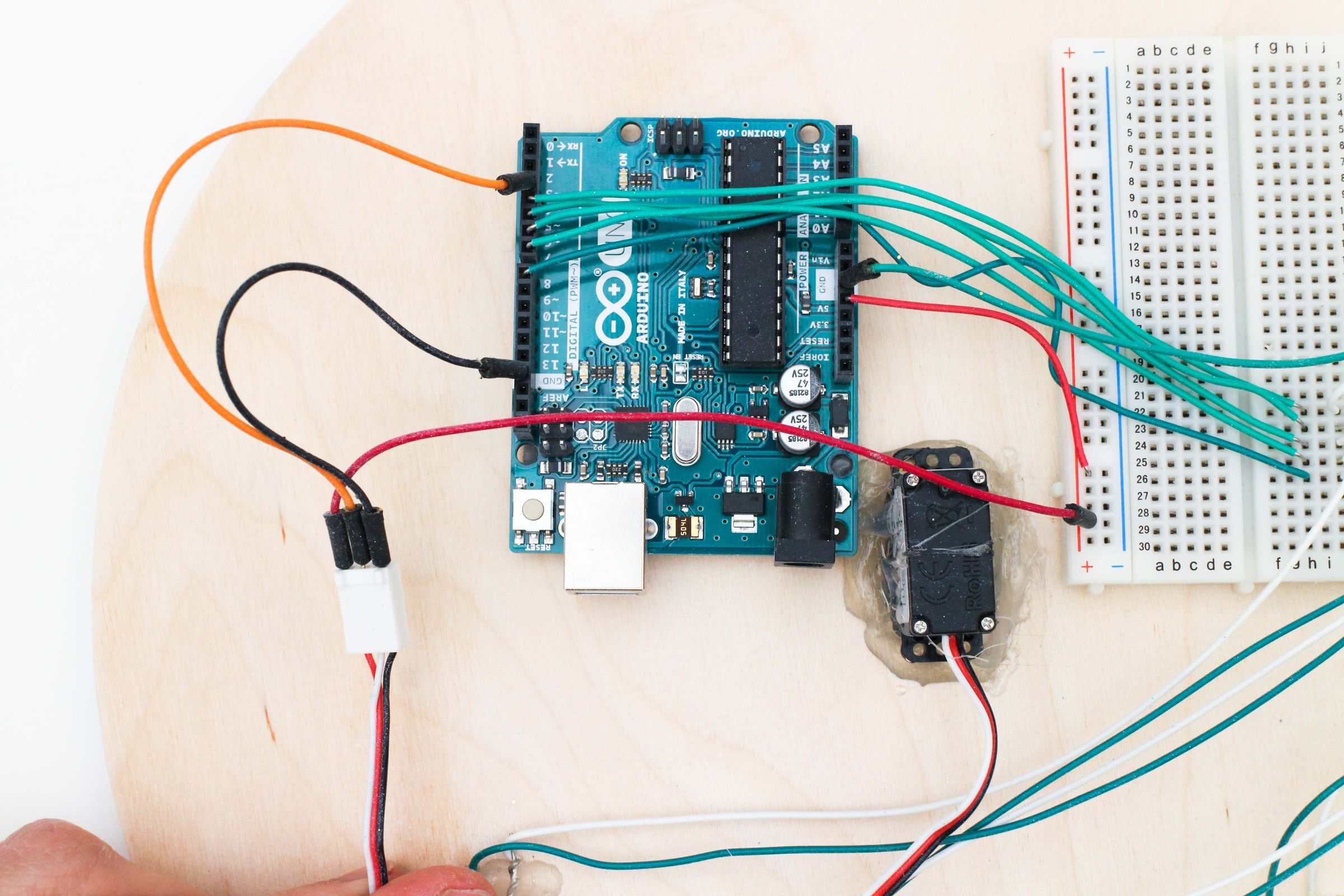

Step 9: Wiring Servo Motor
Begin by plugging in the servo power wire into the 5V pin on the Arduino. Then plug in black wire to GND and the signal cable (your might be white or orange depending on your servo) into a pin with PWM capability, I used pin 3. Once you have your servo plugged in and your LED's plugged in add a wire form the Arduino GND to the ground rail being used by all the LED's.

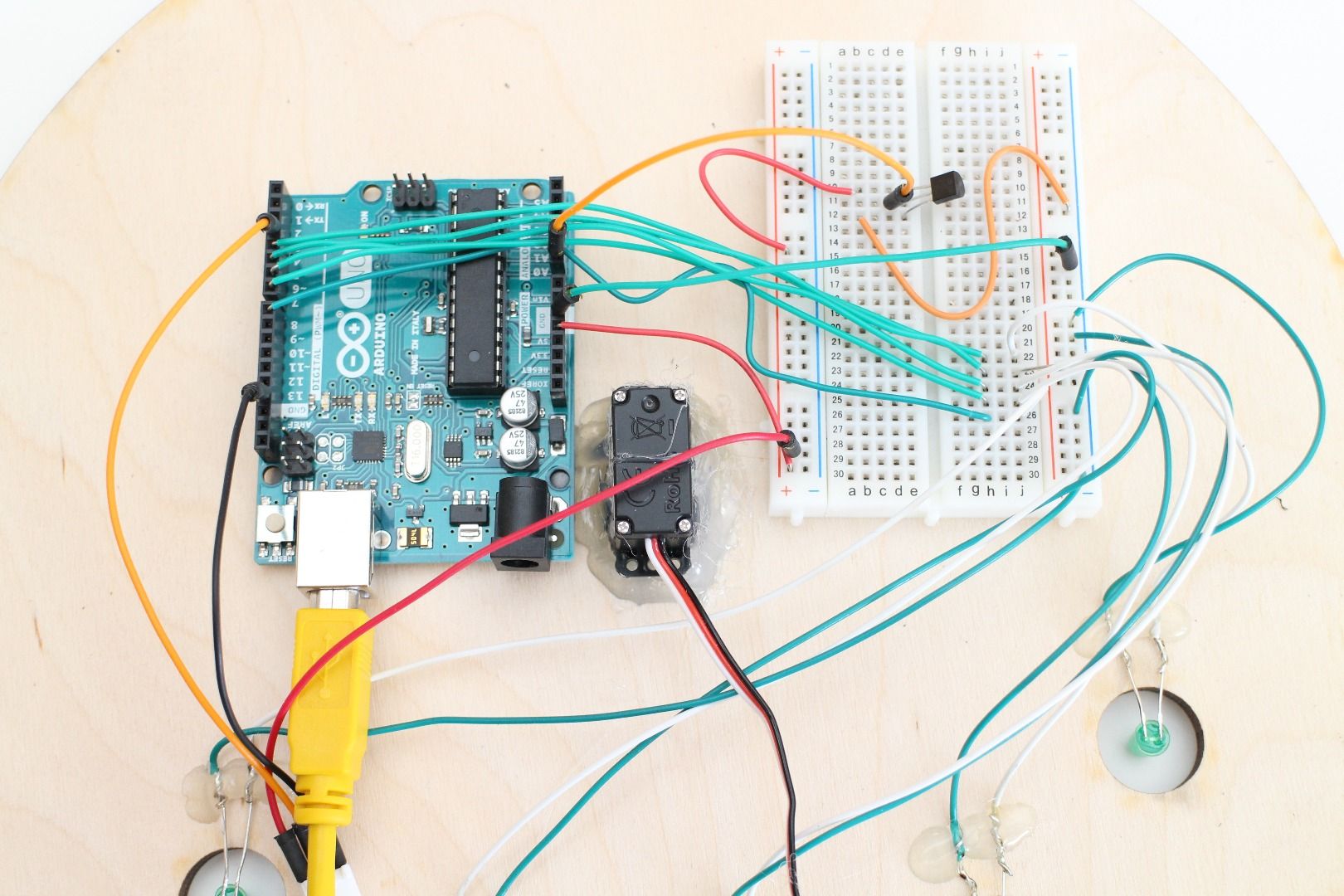

This temperature sensor works by changing voltage depending on the temperature in the room, very similar to the way the light sensor would change voltage based on how much light was in the room. To wire up the temperature sensor begin by placing a wire from the middle leg, which is signal, to the A0 pin. In my circuit the signal wire is orange.
Then you are going to want to add power and ground to the sensor. This will require a slight modification to the servo motor circuit. Instead of plugging in the servo power directly into the 5V pin on the Arduino, run a wire from 5V power to the breadboard and then plug both the temperature sensor and the servo into the same row. If your circuit looks similar to the one below you're on the right track.
