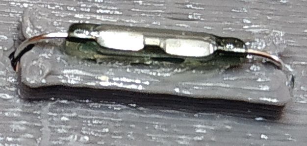

For the construction of the matrix of reed switches I used 36 switches like the ones in the picture. I printed the support on the 3D printer and I also printed a simple template with which I can bend the legs of the reed contacts so that the magnet acting on the contacts from above is parallel to the movement of the reed contact contacts, see also the graphics from previous step and the picture below.
Also the bending of the legs must be done carefully because the glass balloon of the reed contact can break easily so it must be made with a little attention. The template helps in this as well. I then made the connections according to the scheme above. Between the connections you notice that I glued some self-adhesive paper to insulate the connections between the lines and columns.
