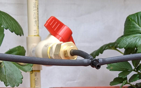

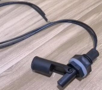

This next part takes a bit of plumbing. I installed a small 10-15 gallon RV tank at the bottom of the greenhouse. From there I ran PVC piping from the tank branching out to micro tubing at each level of the greenhouse. These small RV tanks are perfect for this kind of project. A small water pump can be attached to the bottom 1/2 inch female NTP opening and the horizontal float level switch can be installed at the 1.5 inch female NTP fitting on the opposite side.
A solid state relay will be used to activate the pump. The Arduino will first check the float switch to ensure that there is water in the tank. This will prevent the pump from running dry.

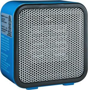

To prevent damage or freezing during the coldest part of the winter, I installed a small space heater, that is activated by a solid state relay. It's not necessary to keep the greenhouse at super warm temperatures. It just needs a little heat to keep the interior temperature above freezing. The DHT22 will monitor the temperature and humidity in the greenhouse and be used to determine when to activate/deactivate the heater.

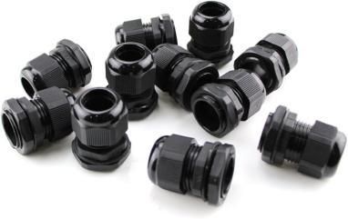

Very important to put all the electronics in a waterproof box with waterproof bulkhead connectors

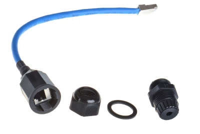

While preparing and mounting all the components, don't forget to first mount the Ethernet shield to the Arduino Uno. Make sure the Cat6 Ethernet cable is rated for outdoor use. If you dont want to run cable, Arduino makes a WiFi shield for the Uno.
