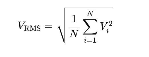

The simplified way to calculate the RMS value of a signal is:
RMS = SQRT [1/n * (x(t1)^2 + x(t2)^2 + .. + x(tn)^2)]
(See attached image)
For a sinusoidal signal, the RMS voltage can be approximated as:
Vrms = Vp * 0.7071.
Irms = Ip * 0.7071.
Keep the RMS formula in mind as it provides a practical way to calculate the Vrms and Irms values we'll need and use later.

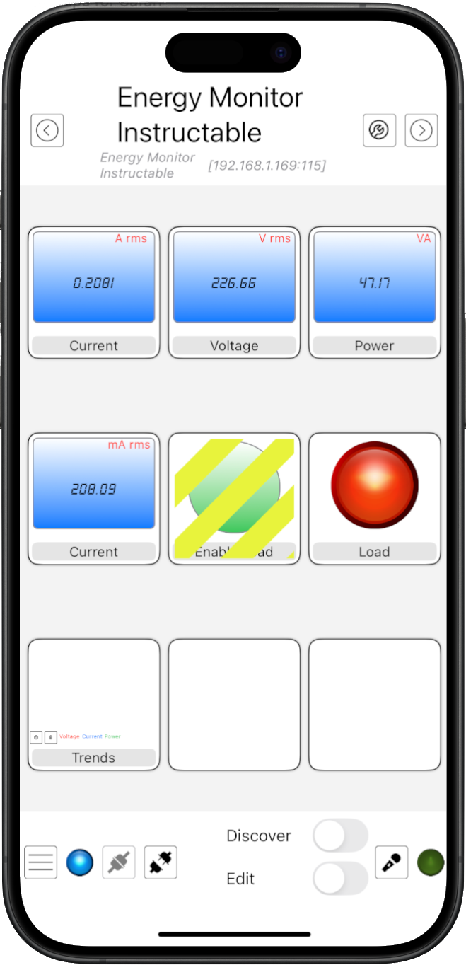

The Widget List is divided into two pages: the first displays the measured voltage, current and power, shows the power trend over time, and allows manual rearming of the load if needed.
The second page is for device setup and calibration.

  3. voltage_rms (current_rms): calculates the RMS value of voltage (or current) based on the formula outlined in Step 1

In Arduino Manager use the plus and minus button of the Threshold Widget to set the maximum power that the load can consume.
If the load temporarily exceeds this limit, it will automatically disconnect. To restore power, press the Enable Load button.

Compile and run the program again, after after a few minutes, you can view the graph by pressing the reload button on the Trends Logged Data Graph Widget.
Step 17: Wrap Up
Using Arduino Manager, we’ve created an efficient interface to monitor the power consumption of a load and control it remotely in a simple and effective way.
