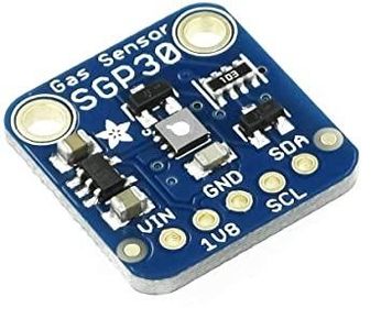

Step 2: About the SGP30 Air Quality Sensor
This is a very fine air quality sensor from the sensor experts at Sensirion, with I2C interfacing and fully calibrated output signals with a typical accuracy of 15% within measured values. The SGP combines multiple metal-oxide sensing elements on one chip to provide more detailed air quality signals.
This is a gas sensor that can detect a wide range of Volatile Organic Compounds (VOCs) and H2 and is intended for indoor air quality monitoring. When connected to your microcontroller (running our library code) it will return a Total Volatile Organic Compound (TVOC) reading and an equivalent carbon dioxide reading (eCO2) over I2C.
The SGP30 has a 'standard' hot-plate MOX sensor, as well as a small microcontroller that controls power to the plate, reads the analog voltage, tracks the baseline calibration, calculates TVOC and eCO2 values, and provides an I2C interface to read from. Unlike the CCS811, this sensor does not require I2C clock stretching.

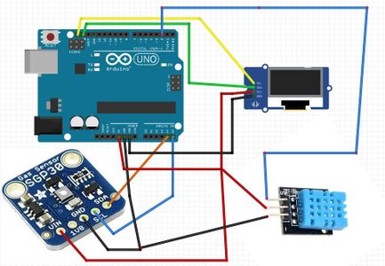

  • Connect OLED Display pin [SCL] to Arduino pin [SCL]
  • Connect OLED Display pin [SDA] to Arduino pin [SDA]
  • Connect OLED Display pin [VCC] to Arduino pin [5v]
  • Connect OLED Display pin [GND] to Arduino pin [GND]
  • Connect SGP30 Sensor pin [SCL] to Arduino pin [SCL]
  • Connect SGP30 Sensor pin [SDA] to Arduino pin [SDA]
  • Connect SGP30 Sensor pin [VIN] to Arduino pin [5v]
  • Connect SGP30 Sensor pin [GND] to Arduino pin [GND]
  • Connect DHT11 Sensor pin [VCC] to Arduino pin [5v]
  • Connect DHT11 Sensor pin [GND] to Arduino pin [GND]
  • Connect DHT11 Sensor pin [S] to Arduino Digital pin [2]

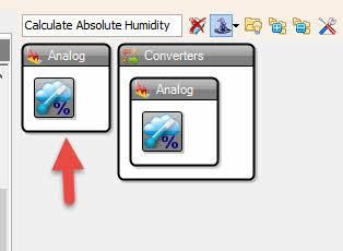

  • Add "Absolute Humidity" component

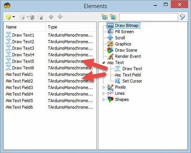

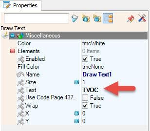

Double click on "DisplayOLED1" and in the "Elements" window drag 6X "Draw text" to the left side and 6X "Text Field" to the left side
  • On the Left side select "Draw Text1" and in the properties window set Text to "TVOC"

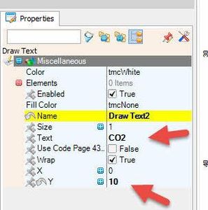

  • On the Left side select "Draw Text2" and in the properties window set Text to "CO2" and Y to 10
  • On the Left side select "Draw Text3" and in the properties window set Text to "HYDR" and Y to 20

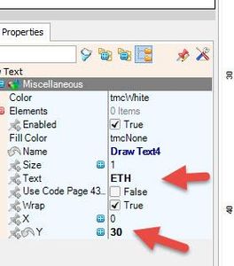

  • On the Left side select "Draw Text4" and in the properties window set Text to "ETH" and Y to 30
  • On the Left side select "Draw Text5" and in the properties window set Text to "TEMP" and Y to 40
  • On the Left side select "Draw Text6" and in the properties window set Text to "HUM" and Y to 50

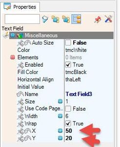

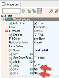

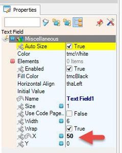

  • On the Left side select "Text Field1" and in the properties window set X to 50

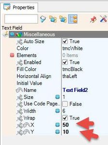

  • On the Left side select "Text Field2" and in the properties window set X to 50 and Y to 10
  • On the Left side select "Text Field3" and in the properties window set X to 50 and Y to 20

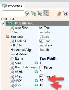

  • On the Left side select "Text Field5" and in the properties window set X to 50 and Y to 40

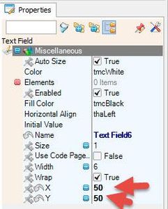

  • On the Left side select "Text Field6" and in the properties window set X to 50 and Y to 50

  • Select "AirQuality1" and in the properties window select Absolute Humidity and click on the Pin Icon and select "Float SinkPin"

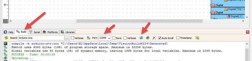

Step 7: Generate, Compile, and Upload the Arduino Code
In Visuino, at the bottom click on the "Build" Tab, make sure the correct port is selected, then click on the "Compile/Build and Upload" button.
