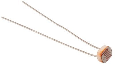

Step 1: LDR
It stands for “Light Dependent Resistor”. It ‘s a type of resistor whose value changes with intensity or the amount of light falling on it. As the amount of light falling on it increases the its resistance decreases and the other way round.
We have made a circuit to give out a logic of 1 or 0 for our Arduino Board. The Circuit can be inverted in order to change the logic.

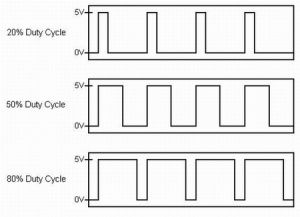

Step 3: PWM (Pulse Width Modulation)
Pulse Width Modulation is a technique in which the width of the pulses can be varied according to the message signal. In this case the led is connected to a PWM output pin of the arduino board and using the analogWrite() function we make the width of the pulses on the pin vary. Varying the width of the pulses can be seen as varying the average voltage on the pin. So although we are only changing the amount of time for which the led is on or off, due to the persistence of vision it is as if we are varying the voltage across the led which causes it to fade and brighten up.

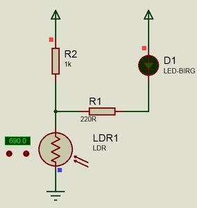

Step 5: Connections / Circuit
The connections are as follows:
  • Connect one end of a resistor ( I have a 1k one…you can use any other value if you prefer.. just make sure it is not too high or too low) to the 5V pin of the arduino board. Connect the other end of the resistor to one end of the LDR. The other end of the LDR should be connected to the ground (GND).
  • Take a wire from the junction of the resistor & the LDR connected earlier and connect it to the Analog Input 5 on the arduino board.
  • Next take a wire from any of the PWM pins on your board and connect it to the Anode of the LED. Connect the cathode of the LED to one end of a resistor with the other end connected to the GND.

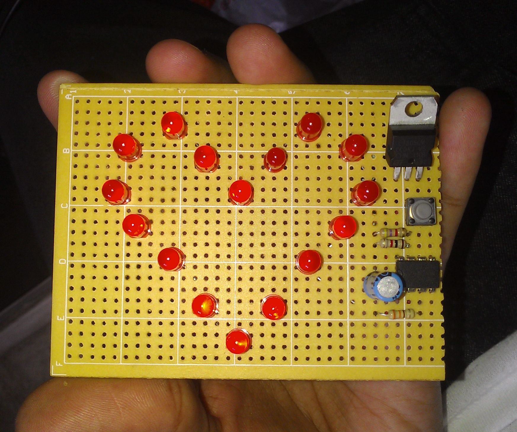

Step 8: Final and Complete Model
So I soldered a more solid board for final experimentation. I used Red LED here as it showed the dimness and brightness light better than crystal light.
