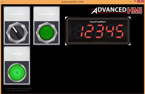

The SCADA:
I drawn quickly a very simple Scada to test a bidirectional communication with the modbus TCP protocol.
A pushbutton to light a led connected on the reachable outputs of the Mega board, a lcd display which displays the value 12345 send by the Mega board and a pilot light also controlled by the Mega board (red: off, green : on). Source code given.
