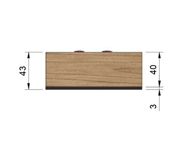

Step 1: CAD Models
I first developed the product using CAD (Fusion 360). The illustrations above represent my final chosen design using teak wood and black acrylic. CAD models are useful to understand what your product looks like with all the pieces together and to check if they will fit together in the first place.
Step 2: Cutting the Wood
The first step of this process is to produce the frame of the product. I did this using teak wood, a table saw, and a miter saw. The wood that I used was 10 mm thick and all pieces were 40 mm wide. The two longer pieces were both 200 mm in length while the two shorter pieces were 110 mm in length. I used a miter saw to cut 45 degree angles at all corners as shown above. These angled edges can be used later on to form miter joints allowing for a sturdy frame.
