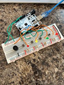

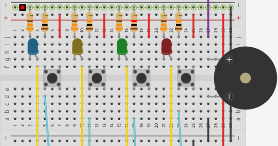

Step 1: Place the LEDS, Buttons, Buzzer, and Resistors to the Breadboard
Place the LEDS, buzzer, buttons, and resistors into the breadboard like so in the image provided. Ensure that there is adequate spacing between the LEDs, buttons, and piezo to get a neat and organized look. Make sure the negative legs of the piezo and LEDS are connected to the ground rail of the breadboard. Connect a 10k resistor to one leg of the buttons to the ground rail too.
Step 2: Connect Everything to the Arduino
Using Jumper wires connect the following LEDs and piezo follows:
  1. Red LED to pin 7
  2. Green LED to pin 8
  3. Yellow LED to pin 9
  4. Blue LED to pin 10
  5. Pizeo buzzer to pin 12
Using Jumper wires again connect the corresponding buttons of the LEDs to the Arduino:
  1. Red button to pin 2
  2. Green button to pin 3
  3. Yellow button to pin 4
  4. Blue button to pin 5
