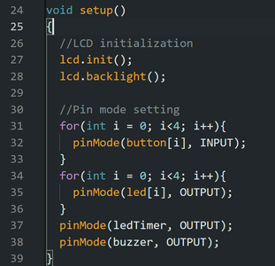

Step 8: Void Setup
Now for the void setup we're just initializing pinModes for all LEDs, buttons, and the buzzer. As well as initializing the LCD to be used.

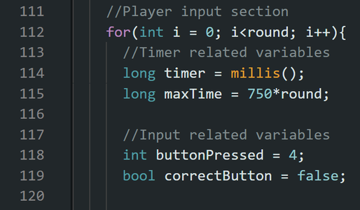

Step 13: Setting Up the Input
Before actually getting into the input we need to declare some variables. Timer and maxTime will be used to decrease the ledTimer's brightness to match the actual time give, which will be seen in the next step.
buttonPressed will be related to the function we just created and this int will be used in the input section to check if the player's inputs were actually correct. It's initialized to 4 as 4 means no input.
correctButton will be used if the timer runs out, later checking if the player's input was correct before the timer ran out (which it shouldn't be since the player didn't have time to input) to move the player to the youLose() function that will be defined later.
Step 14: Getting Player Input
This loop will let the player actually have time to input, only exiting when either an input is made or the player runs out of time.
When it comes to the ledTimer logic:
  1. timePassed checks how much time has passed since entering the loop in the same way the loop condition does
  2. timerBrightness is mapped so that it is its highest value when the least time has passed and lower when more time has passed
  3. timerBrightness is then analog written to the ledTimer to slowly make the LED fade as the timePassed approaches maxTime
The following if statements first check if the player even has input something, if so, the nested if statement checks if the input is correct. If the input is correct, correctButton is changed to true and the LED will flash just as it does when showing the pattern.
