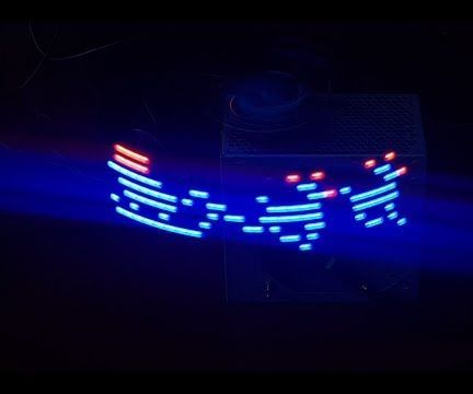

Switching on, metronome mode will start at 60 BPM showing on the small display and letting the pace be tuned by the rotary knob between 10 and 240. Neopixels show the beat in blue LEDs while the buzzer ticks. Pressing the knob will switch to beat adjustment mode and green LEDs will indicate the set beat structure. Rotary knob will increment or decrement the beat structure (2/2, 3/3, 4/4, 6/8, etc.). Above 8 LEDs, further rotating clockwise, leading accent will be turned on, and the first LED will indicate this in red. Leading accent will have audible feedback as well. It can be turned off by rotating counter-clockwise. Pressing the knob will switch back from beat adjustment mode to metronome mode.

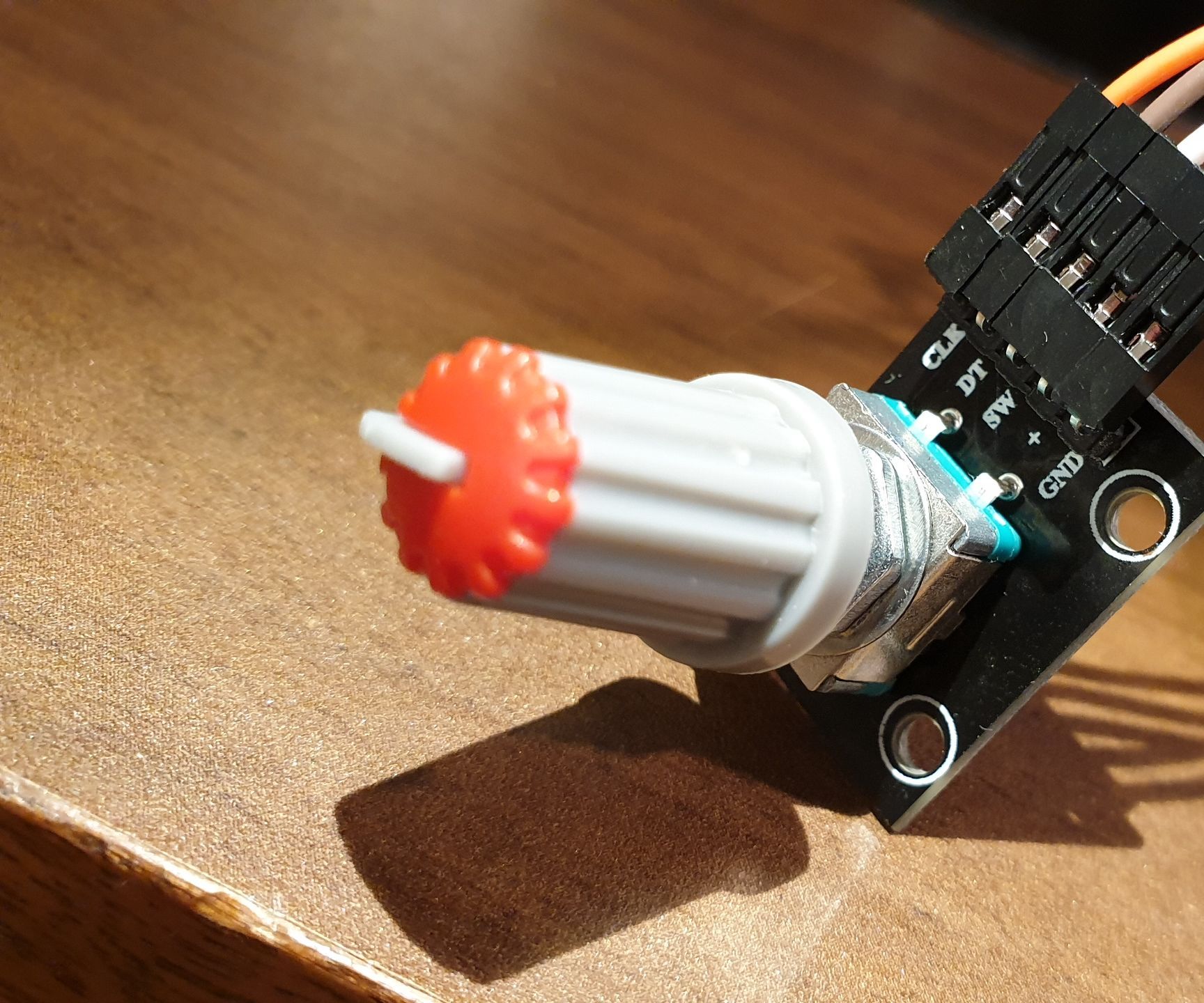

- Rotary encoder, USD 0,50

Use the Nano IO Extension Board so as not to bother with soldering multiple GND and VCC connections. Minimal soldering will be needed for the Nano pin headers and for the Neopixel module connectors. Using Dupont wires allows stable connections for the rest of the wiring as shown on the diagram. The 9V battery is connected to GND and VIN, the latter through the power slider switch. The rotary encoder module has an integrated switch button, that is shown separately in the diagram for easier understanding of how to connect them. Rotary part (CLK and DT) is connected to PIN2 and PIN3 respectively, because these are the only NANO pins capable of Interrupt handling. Rotary GND is connected to Nano's GND PIN of course. The integrated switch button is connected to PIN4. Piezo buzzer is connected to PIN5 and GND. Adafruit Neopixel module is connected to PIN7 and its VIN and GND to Nano's 5V and GND respectively. Small OLED display is connected to the I2C bus interface, which is PIN A4 and A5 for SDA and SDL. VCC and GND goes to Nano's 5V and GND of course. That concludes our Dupont wiring.
