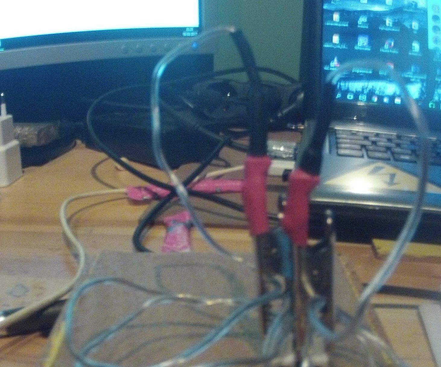

Step 3: The Electronics Box
The electronics box is made from some leftover multiplex(12mm thick) I had laying around. In the drawings you can find all exact sizes.
NOTE: the mid panel is from plywood (5mm)
In one of the side of the box is a notch, this is where all the wires wil go through.
To make the notch:
- First measure the notch and mark where the notch has to be.
- Drill with a 6mm drill every 6.1mm 3mm above the bottom line
- now you will be able to cut out the rough shape of the notch
- use sanding paper to make it a clean notch (this might take a while and is not the most fun part of making the box)
after you have cut all the wood and made the notch you can glue the box together.
Before glueing the mid panel in
- install rca plug (or 6.3mm jacks). Normaly you can just screw the rca plugs in. I have used some extra glue to be sure.
- If all the rca plugs are conneted you have to connect all the long pins of the rca plugs using some electric wire and a solder iron.
- at the end you have to solder one wire wich will go to the electronics. Mark this wire as it will be the ground wire.
- At every short pin on the plugs you have to solder a wire as well. These wires will be the input on the electronics.
- now glue the mid panel in

Step 5: Testing Electronics
I have used my arduino leonardo as a scoop to test the electronic sheme. I also used it to try different materials and stuff for the drum pads.
The program to use your arduino as a scoop is included.
The input channel is analog 0 (A0). Make sure you never put more than 5 volt on the arduino! to make sure I didn't I have used the opamp. The opamp is power with 5 volt and the output will never be more than 5V.
The program starts registrating as soon as the input goes over the treshold value. The input value is shown on a scale between 0 and 1024.
Because this scope does not registrates the whole time it is verry handy to figure out the schematics and what materials are best for the drumpads.

Step 6: The Circuit I Used
I have used a verry simple circuit. It gave a nice result.
I have include another circuit wich I found somewhere on the internet and might work better. I haven't had the time yet to test is. So if anyone uses it please let me know how it is.
If anyone has a quenstion about the electronics feel free to ask, I'll be happy to answer .
At this point you have to solder the circuit. The ground of the circuit is connected to the long pins from the rca plugs a few steps earlier. The + side of the piezo on the diagram are the short pins of the rca plugs.
