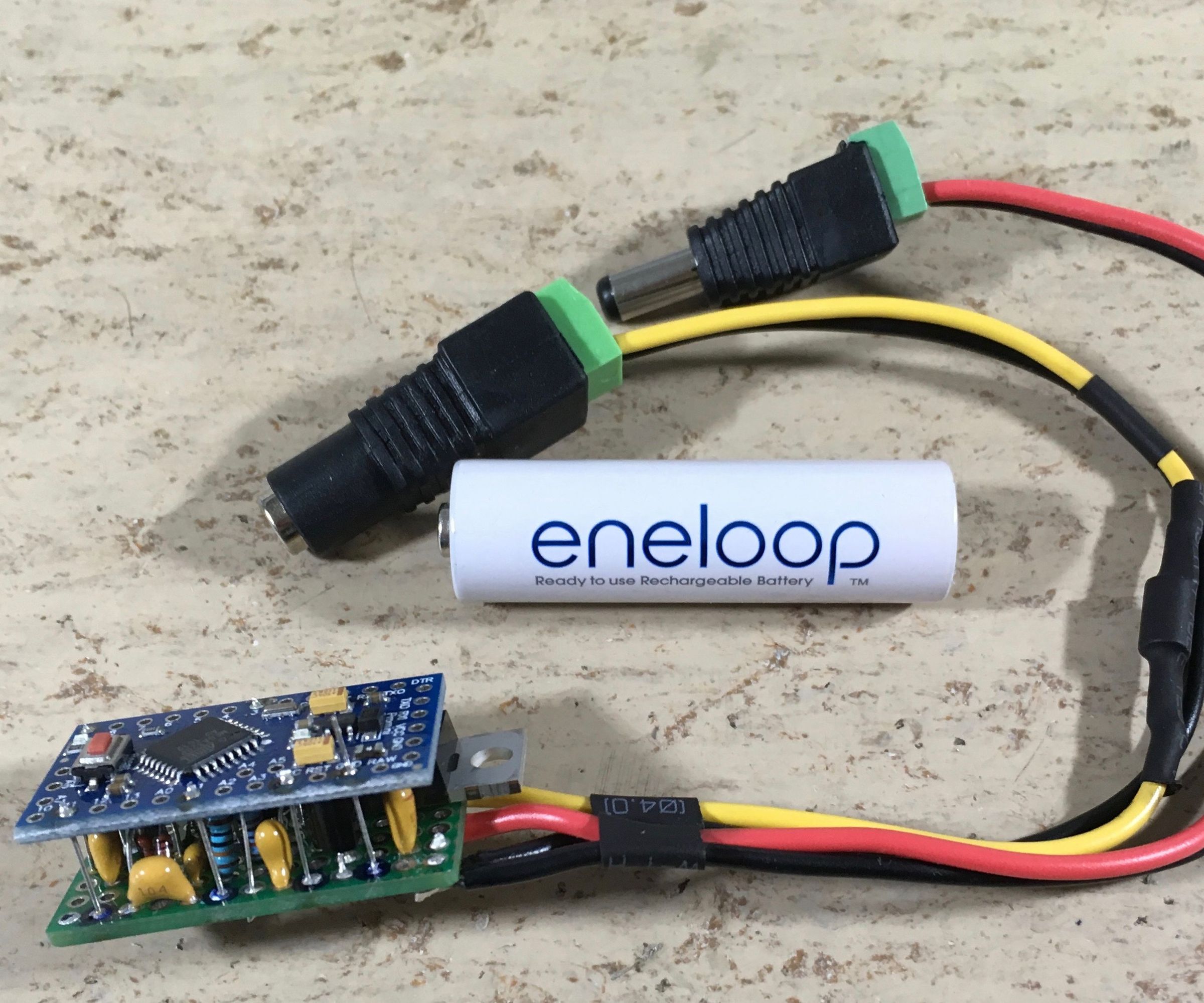

Technical specification receiver:
- Input voltage range 3.5 - 8.5V (be careful with your servos, they usually require 4.8 - 6V)
- 4 standard RC servo outputs
- TB6612FNG dual channel DC motor driver integrated, so you don't need an additional ESC for smaller models (two versions available, see step 3)
- Lots of vehicle software configuration options, such as differential steering for caterpillar models, headlights, taillights, brake lights, indicators
- I2C and Serial headers (can also be used for lights)
Documentation on GitHub: https://github.com/TheDIYGuy999/Micro_RC_Receiver

The easiest way to do the necessary steps is described in the videos above. The shot air soldering is shown in the Porsche video. After soldering, use a magnifying glass and have a close look for shorts between the pins! Some rework, using flux and the soldering iron may be necessary.
