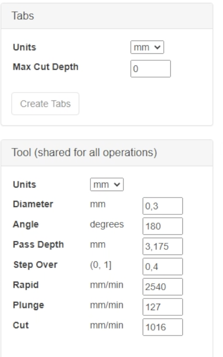

Step 6: Vector File to G-code
We will use the JSCut web tool to convert the vector file to G-code. The interface opens with predefined settings, download and upload the file containing the project settings shared on the PCBWay project page (I could not attach it because the file extension is not supported here). Then, mark it to return to the zero point at the end, and adjust the pen tip width. Load the vector file, select it, and choose to create operation, there are several types of conversion options, choose the one that works for you, and click generate. Finally, save and download the g-code.
