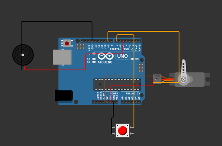

Step 1: Designing and Testing
I started by making a design for my vending machine and thinking about the layout for the mechanical components as well. When I came to a design I was happy with, I started to experiment with the individual components I had. At first I had only planned to make a regular vending machine, but when I had gotten the servo rotating at the push of the button, I found the project to be too boring. I then figured that a vending machine that could play music and have the hatch open at the rhythm of the song would be more interesting, so I started to experiment with that layout to get it all working.
After I was finished with the layout, I polished up the code to have the servo turn with the rhythm of the song. The song I had to code in myself. The video shows one of my tests for this.

Step 3: Soldering
I stripped some wires, I then moved the design to a printed circuit board and soldered the parts together (buzzer and button). Soldering helps components stay on more secured.

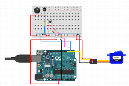

Step 5: Reflection
This was my first time using an Arduino, so in general I’m pretty satisfied with the end result. By the time I had finished this project, I realized the electricity for the buzzer and button should’ve gone through a resistor (The picture here is what I probably should've used as layout, or I probably should've started with creating the layout with a program from the start). I also didn’t fully design how the candy would fall into the box with wood, so I ended up using scrap wood to craft something that would make the candy lean towards the opening of the vending machine. Nevertheless, the project is still functional. Learning how to solder and how to use a laser cutter has also been very useful and fun. I’ve realized Arduino might not be something I’d want to do for a second time, but I’m still really happy with what I’ve built and I got to learn something new.
