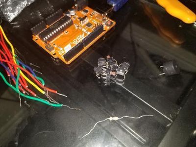

Introduction: Arduino Mini Piano
This is a Mini piano made in Arduino with Push buttons and a buzzer, can make songs or do what ever you like.

Step 2: Step 2: Put It Together
Start off with the push buttons, place them like how I did in tinker cad then wire one of the legs of the push button to the GND (Negative Terminal -) part of your breadboard Do this to all the push buttons showed with the black wire in the tinker cad screenshot. Then Get a different color wire (Optional) and wire the other leg of the push buttons to one of the Digital Pins in the Arduino, Use numbers 4-10 for the push buttons. 1st Button being 4 and last button being 10.
After that all the push buttons should be wired and ready.
Now to wire the buzzer, You will need the 560 ohm resistor and to more wires for this one. Place the buzzer not too close to the buttons so you have space. For the buzzer the short leg is GND (-) and the other leg goes to one of the pins.
Place a wire from the short leg to the GND (-) part of the breadboard then place the resistor on the other leg. With the other leg of the resistor place a wire, and wire it to Digital pin 11.
