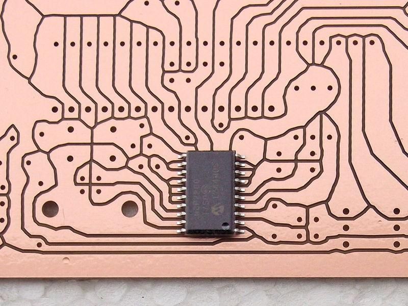

Introduction: Arduino Mobile
The purpose of this PCB is to provide a board similar to the ARDUINO UNO but dedicated to embedded projects (ie powered by batteries).
Why ? Because you cannot power an arduino uno for a long time using batteries. Mostly because the USB feature takes few mA, even in sleep mode. The voltage regulator also needs at least 7V to work normally, a too high voltage for efficient use with batteries. And the last problem is the power green led, also few mA.
With the arduino mobile you can power the board from 1.8V up to 5.5V. There is no USB capability anymore or almost, we will see that in the next steps, no voltage regulator and no power LED.
When in sleep mode, the arduino mobile takes only few uA. It can last months on cells.
The pinout is the same as the arduino uno and the integrated led connected to pin 13 is still there.

Few capacitors, a 16Mhz crystal, a LED for pin13 and that's all !!
Step 2: Let Make the Board
I've attached in this instructable the Eagle files of the schematic and the PCB.
I recommend OSH Park to make this board but any other provider should be able to do it.
If you are not familiar with Eagle and PCB making, feel free to contact me. I can send you a PCB.
