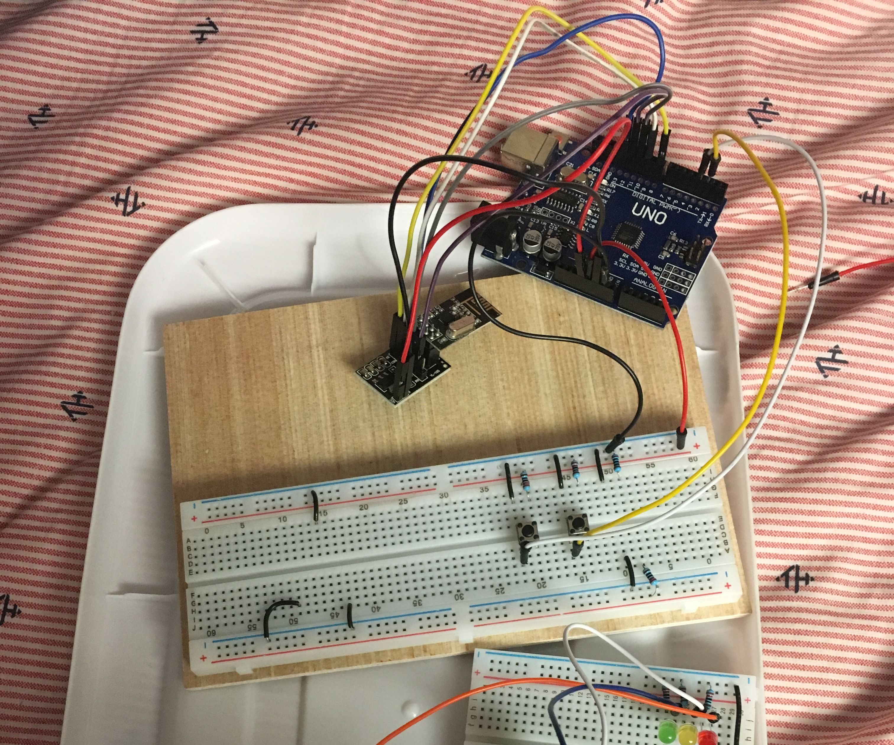

I made a Morse-to-English and a English-to-Morse encoder and decoder. This entails the use of two buttons, the LCD display, an LED, and an Arduino Uno. The functionality is as follows: one can enter a Morse code message by using the two buttons (dot/dash and go) and the Arduino chip will translate that to English and show it on the LCD/serial monitor. One can also enter a English phrase on the serial monitor and have the LED light up with the corresponding Morse code flashes.
Step 1: Electronic Design
The electronic design is fairly simple.
The LED is connected to pin 8 through a 220 ohm resistor. The two buttons are connected to a 5 volt rail through a 220 ohm resistor on one side and a pin input (3 and 10 respectively) on the other side.
The LCD display wasn't actually connected through its base pins, instead I used a backpack with 4 pins (5v, ground, SDA connected to the A4 pin, and SCL connected to the A5 pin).

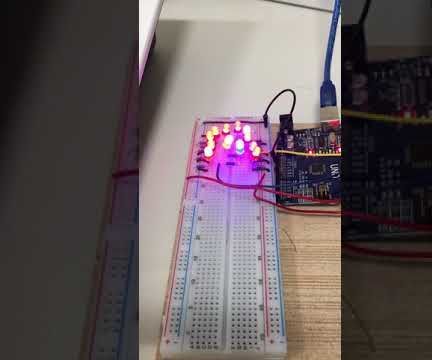

I initially wanted to do this with one button but without parallel computing it was near impossible to decide between a pause between symbols and the end of the letter. I also wanted to do this while using under 50% of memory which I accomplished (49%)!
There's a lot of room for expansion for this idea, which I could potentially tackle in the future. Other than that, here's some film of it in action!
