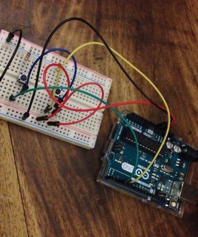

Step 3: Assemble the Morse Code Machine
The morse code machine should be assembled as pictured above. The machine gets its power from the Arduino power cable, so make sure to keep it plugged in while you use the machine. Use different coloured wires to not get confused.
For the box you can used whatever looks good. You will need to cut at least two holes, one to show the speaker and the LED light and one in the back so you can plug in the Arduino cable, as it needs to be connected to get the power necessary to work.
