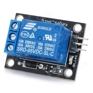

5. A 5v relay

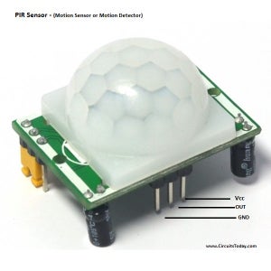

7. A motion sensor (PIR)

Step 2: Connect the PIR Sensor to the Arduino
1. Connect the VCC pin to the 3.3v.
2. Connect the GND pin to the ground.
3. Connect the OUT pin to the digital pin 4.
Step 3: Connect the 5v Relay to the Arduino
1. Connect the GND pin to the ground.
2. Connect the IN1 pin to the digital pin 8.
3. Connect the VCC pin to the 5v.
