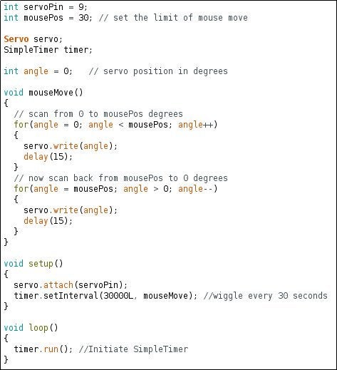

The Arduino sketch is attached. Make sure you have the Servo.h and SimpleTimer.h libraries installed before uploading the sketch to your nano. You may change the angle in which the servo will travel, and the time interval that the servo will move. The default setting is the servo will move the wheel 30 degrees to the left then 30 degrees to the right every 30 seconds. This will make your mouse move for about 10 mm which is enough for keeping the computer from sleep, yet not too much to lost track of the mouse cursor. You may adjust these values as you desire.

6 months ago on Step 3
Hey great project, I have run into a snag while compiling the Arduino sketch. I received this error and was wondering if anybody knew how to fix it. The code seems right and is unchanged, so it could be a version issue. ANy help is appreciated, Thanks!
Reply 2 months ago
Same error here. The modified code I posted in another comment works.
Reply 5 months ago
It looks like you might be trying to use a different version of SimpleTimer. You can obtain a compatible version of the SimpleTimer used from Arduino Playground. https://playground.arduino.cc/Code/SimpleTimer/#Ge...
You just need to get the SimpleTimer.ccp file and the SimpleTimer.h file. Then replace one line in the main code that is posted in the article.
In the main code, change the include line to:
#include "SimpleTimer.h"
See images below:

Reply 5 months ago
Try moving the entire function of "void mouseMove" above the "void setup" function and then compile. See attached image for example. Hope that helps.

This code will work for the version of SimpleTimer that I got from the Ardiono Library Manager:
