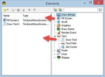

  • Double click on the "DisplayOLED1" and in the "Elements" window:
  • drag "Fill Screen" to the left side

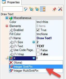

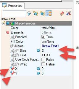

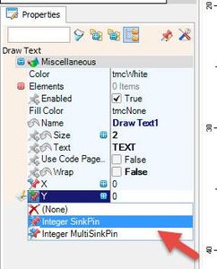

  • drag "Draw Text" to the left side and set in the properties window set "Size" to 2, "Text" to TEXT (Or any other text) and select "X" to and click on the pin icon and select "Integer SinkPin" and select "Y" to and click on the pin icon and select "Integer SinkPin"
  • Close the "Elements" window
