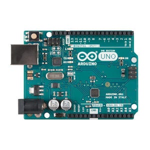

1) Arduino UNO/NANO

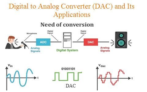

Modern mp3 players have inbuilt Digital to analog converters, which is used to produce the sound very similar to the original one. Microprocessor fetch the song bit wise and then inbuild DAC convert the steps into the analog value, the audio quality is based on the number of steps. That’s why an 8-bit DAC is not preferred for audio output.
Our Arduino only have analog to digital converts which is required to do the same process but in reverse. But there are PWM digital pins which can output a signal similar to audio but a little distorted. So, we will use this feature of Arduino and produce sound using PWM pin. See PWM sound synthesis.

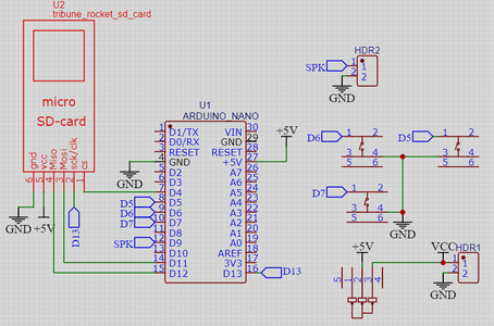

Step 3: Circuit Diagram:
We can connect the SD card using SPI interface as given MOSI, MISO and SCK pins are connected to digital pin 11, 12 and 13 respectively. Chip select can be connected to any digital pin which can be defined high if no errors occurred. Three tactile buttons are connected to digital pin 5,6 and 7 to control the play menu. For the audio output a PWM pin is needed, here pin 9 is defined for the PWM output. A mini amplifier can be connected to this PWM pin with filtered power supply to amplify the signals further.

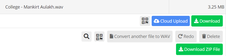

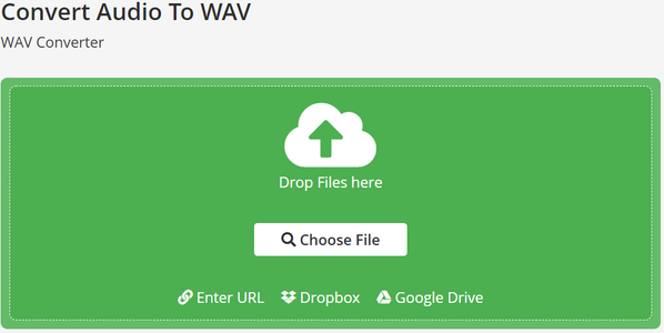

Because of no DAC Arduino can’t play the sound files directly but we can change the format in .wav format. A special online converter is available to convert the full audio files into its compatible wav file. Actually, these wav files are nothing but Waveform Audio File Format is an audio file format standard, developed by IBM and Microsoft, for storing an audio bitstream on PCs. It is the main format used on Microsoft Windows systems for uncompressed audio.
Go to the link given here: https://audio.online-convert.com/convert-to-wav

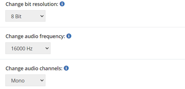

Upload your audio files and change the following data:
Change bit resolution: 8bit
Change audio frequency: 16000hz
Change audio channels: Mono
Change PCM format: U8 (unsigned 8 bit)
Then click to convert and download the respective wav files.

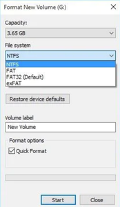

Step 5: Setting Up SD Card:
First make sure that SD card is formatted in FAT32 format, if not then do that first from disk manager in windows. Clear all the data from SD card and then paste wav audio files in it.

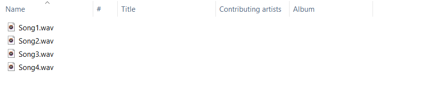

Rename the files as mentioned in program below. Here for songs- music1.wav, music2.wav, music3.wav is used. You can continue this format to as many songs (limited to storage device capabilities).

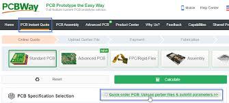

Step 9: PCB Ordering Process:
First go to PCBWAY and register, then in the quote PCB section fill the board parameters. Choose color, quantity and other specifications. Add the sample to your cart. Then submit your Gerber file and you can make the payment after passing review.
