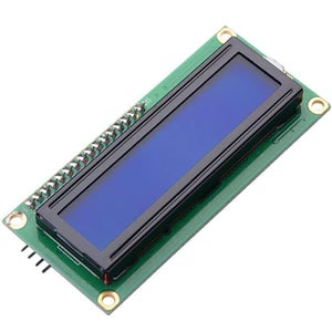

  4. 16x2 LCD with I2C board -1

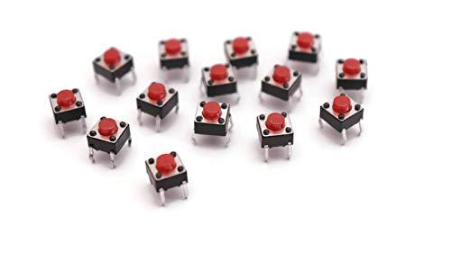

  6. Momentary Switch Buttons - 3
