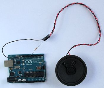

For this project, all you will need is the Arduino, usb cable (for programming), computer, some wires, optional 100 ohm resistor, and an old eight ohm speaker. Usually the back of speakers on the magnet have what resistance they are. So grab the old dead radio or the like that has a speaker and see what it has. Old personal computers are likely to have one too that you can borrow for a minute.
Step 2: The Circuit

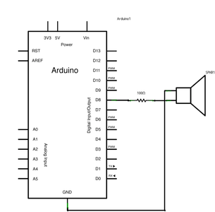

Now you need to build the circuit. It is minimal and you should be able to set it up quickly. Resistor adds safety for protecting the Arduino. Uses digital pin 8 and ground.
Step 3: Original Code.

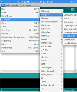

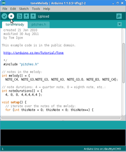

Set up up your Arduino for programming and load the Arduino IDE program into your computer. Then load in the Digital melody sample from the menu. The instructions for your Arduino should tell you how to set up your board. Assuming your tools are set up properly, you can now compile and up load the sketch to your Arduino. You should now hear a set of tones that sounds like it came from a cartoon.

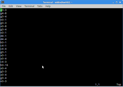

We decided to try doing Silent Night. Of course you need the sheet music to get the notes and the timing. The sketch will provide you with the information of how to translate the notes. So we began doing our own translation using vim to record our results. Since this is 3/4 timing, things will be tricky.
Step 6: The Translation.

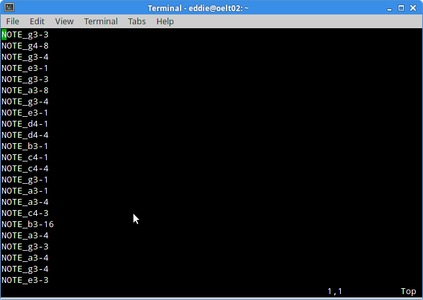

So we began doing our own translation using vim to record our results. Since this is 3/4 timing, things will be tricky. Oops every thing is in lower case and we need to add the NOTE_ to the beginning of the notes. No problem. a g~~ will convert the letters to uppercase and a :%s!^!NOTE_! will the preface to the notes. So far so good. Now we need to separate the notes from the timings. So save the file.

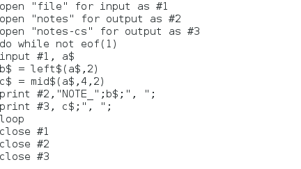

Step 7: Using Basic Instead of Bash.
Freebasic is free and is available for most platforms.
compile with
fbc -lang qb filerdr.bas
filerdr.bas
[code]
open "file" for input as #1
open "notes" for output as #2
open "notes-cs" for output as #3
do while not eof(1)
input #1, a$
b$ = left$(a$,2)
c$ = mid$(a$,4,2)
print #2,"NOTE_";b$;", ";
print #3, c$;", ";
loop
close #1
close #2
close #3
[/code]
file
G3-3
F4-23
notes
NOTE_G3, NOTE_F4,
notes-cs
3 , 23,

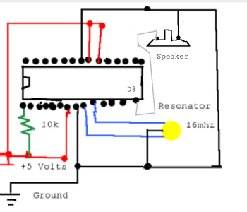

Step 8: Standalone Version.
If you have the Arduino with the removable chip, you can build a standalone version so it can be put in a music box or whatever. You may have to adjust your code depending on what digital pin you use. Add a switch to the battery and you have a neat gift.
