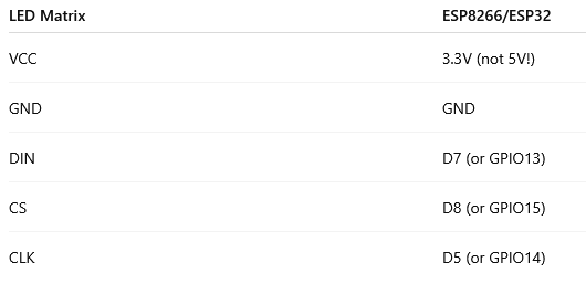

Step 3: Circuit Assembly
Start by placing the ESP board onto the mini breadboard. Then wire the matrix module to the ESP using DuPont jumper cables.
Power is provided through the VIN pin if you use a 9V battery or power bank — make sure to connect it properly using a battery snap or male headers. Connecting the wrong pin may damage the microcontroller.

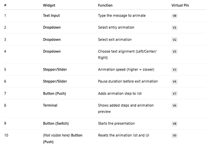

Step 6: Setting Up the Blynk App
Install the Blynk IoT app and create a new template and device. Then add the following widgets and link them to virtual pins (V0 to V9):
  1. Text Input (V0): Enter text to animate
  2. Dropdowns (V1, V2): Entrance and Exit animations (numeric IDs)
  3. Duration & Pause (V3, V4): Set animation speed and pause
  4. Justification (V5): Align text (left, center, right)
  5. Terminal (V6): View saved steps
  6. Buttons:
  7. Add Step (V7, push mode)
  8. Run Animation (V8, switch mode)
  9. Reset (V9, push mode)
Once widgets are configured, you’re ready to start building animations from your phone.
