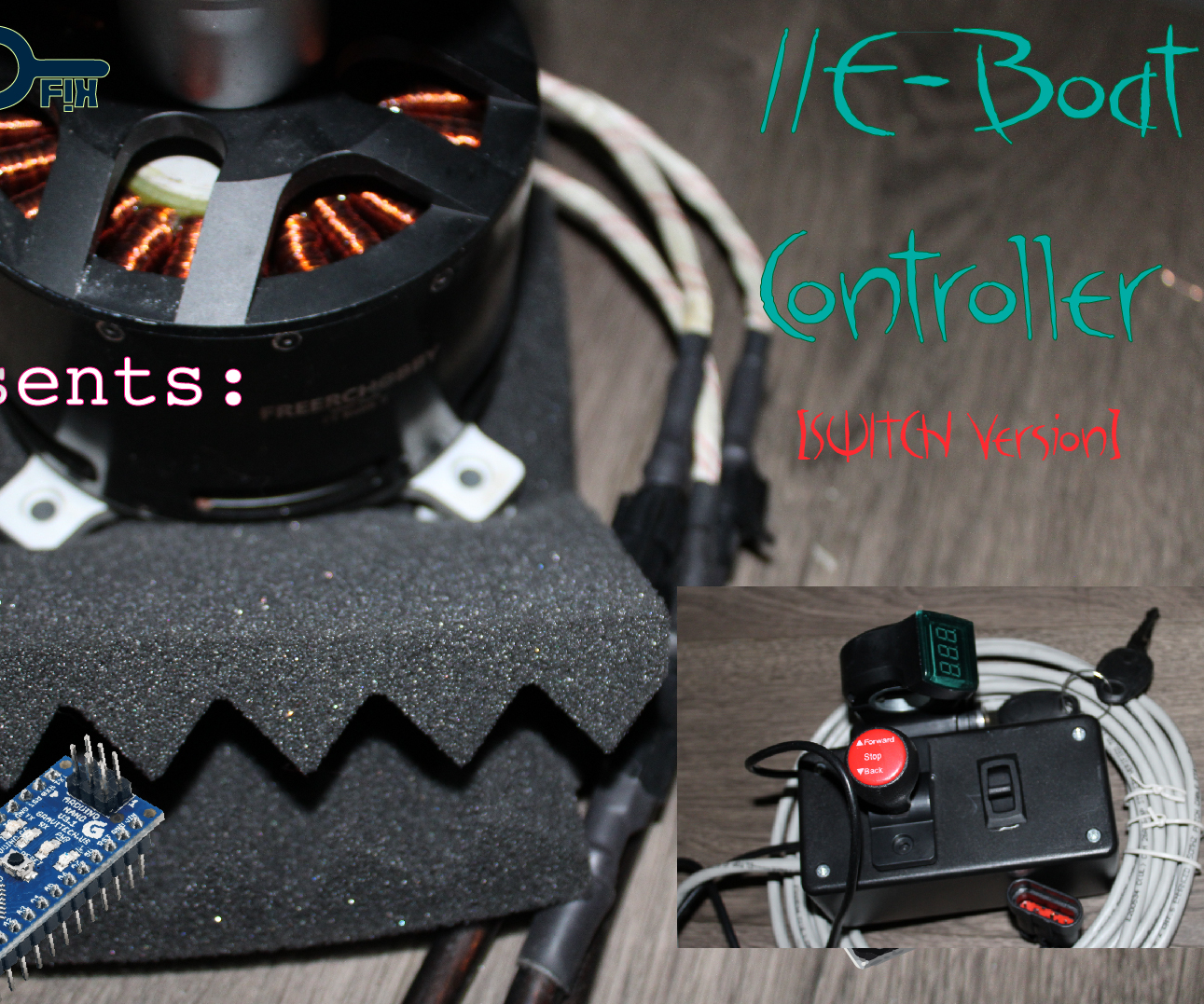

Introduction: Arduino NANO Simple E-boat Controller (Forward, Neutral, Reverse)
About: //<3 Machines
Simple controller for Brushless Motor with ESC and Arduino for docking a Sail Boat.
Switch to control Forward/Neutral/Reverse
Joystick to control the throttle
Ignition Key Switch to turn on the controller.
Arduino Nano x1
1P2T Paddle switch x1
Arduino joystick x1
1KOhm Resistor x2
ESC Acording to the motor size that you will use.
Brushless Motor
Ignition Key Switch
WaterProof Connectors
Heat Shrink Tubing
Controller Box
48V Li-ion Battery
5VDC Regulator (48VDC to 5VDC)
Wires ESC to Motor
Wires ESC to Battery
