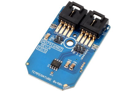

AD7416ARZ is 10-Bit temperature sensor with four single channel analog to digital convertors and an on board temperature sensor incorporated in it. The temperature sensor on the parts can be accessed via multiplexer channels. This high-accuracy temperature sensor has become an industry standard in terms of form, factor and intelligence, providing calibrated, linearized sensor signals in digital, I2C format. Here is the demonstration with Arduino Nano.

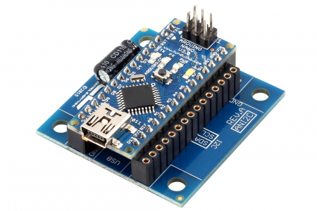

Step 2: Connection:
Take an I2C shield for Arduino Nano and gently push it over the pins of Nano.
Then connect the one end of I2C cable to AD7416ARZ sensor and the other end to the I2C shield.
Connections are shown in the picture above.

Step 4: Applications:
AD7416ARZ is a 10-Bit Temperature sensor with four single channel analog to digital converter can perform the operation of Data acquisition with ambient temperature monitoring. It can also be employed in Industrial process control systems, Automotive Battery-charging applications and Personal computers.
