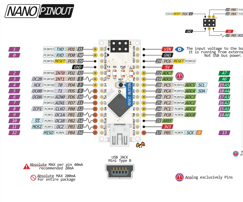

See in the pic there ive circled in the Sketch of the Optiboot loader, the "TARGET" pins that the sketch will search for, now all we need to do is match up those 6 pins to the ZIF Socket and convert from the ATMEGA328P-AU to ATMEGA328P-PU pinout, which really doesnt take long, keep referring to Photo 2 and Photo 3 back and forth and youll get the idea !!
So in the 'TARGET' List we got these pins only;
#define SCK 13
#define MISO 12
#define MOSI 11
#define RESET 10
So thats 4 Pins plus GND & +5v
~ i added GND from the NANO to Pin 8 of the Thru-hole
~ added VCC (+5v) from the NANO to Pin 7 of the Thru-Hole
Thus making only 6 pins used, a little setup time, GUARANTEED RESULT - (SOLVED)
SOLVED !!!!
So we got the SMD version of the Atmega328P Microcontroller (Uc) on the Nano and the Through-Hole uC being sought after in the sketch - but wait, the sketch is intelligent enough to know that once it detects the SMD version of the ATMEGA328P - it will use the SMD.HEX file for its Optiboot Bootloader !
So for example,
Sketch Pins Thru-Hole Pins SMD-Pins Equivalent
SCK 13 19 17
MISO 12 18 16
MOSI 11 17 15
RESET 10 1 29
So now We've Deciphered which pins to target on the NANO board, stick it into a breadboard and wire the pins directly into the Optiboot setup in previous step, which are;
SMD Pins;
15, 16, 17 & 29 (29 is RST {RESET})
