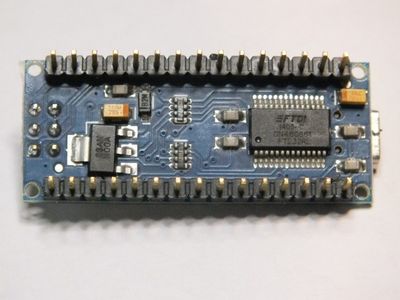

Step 1: The Problem With the Clones
Most of the clones have CH340G Driver, which should have its driver installed in the pc
http://www.wch.cn/download/CH341SER_EXE.html
download this driver then your clones will work
if it still doesn't work then try the old bootloader atmega324
