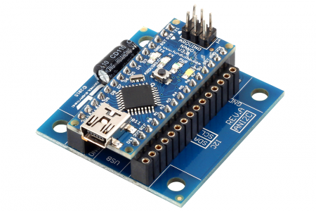

Take an I2C shield for Arduino Nano and gently push it over the pins of Nano.

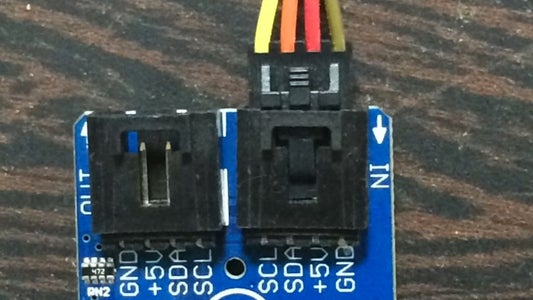

Then connect the one end of I2C cable to MCP9808 sensor and the other end to the I2C shield.
Connections are shown in the picture above.
