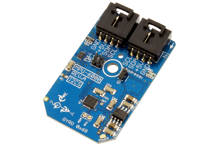

MPU-6000 is a 6-Axis Motion Tracking Sensor which has 3-Axis accelerometer and 3-Axis gyroscope embedded in it. This sensor is capable of efficient tracking of exact position and location of an object in the 3-dimensional plane. It can be employed in the systems which require position analysis to the highest precision. Here is the demonstration with Arduino Nano.

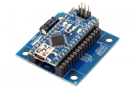

Take an I2C shield for Arduino Nano and gently push it over the pins of Nano.
Then connect the one end of I2C cable to MPU-6000 sensor and the other end to the I2C shield.
Connections are shown in the picture above.
