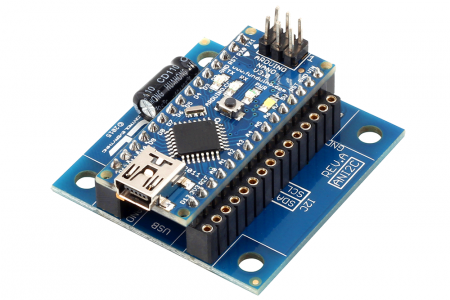

Take an I2C shield for Arduino Nano and gently push it over the pins of Nano.

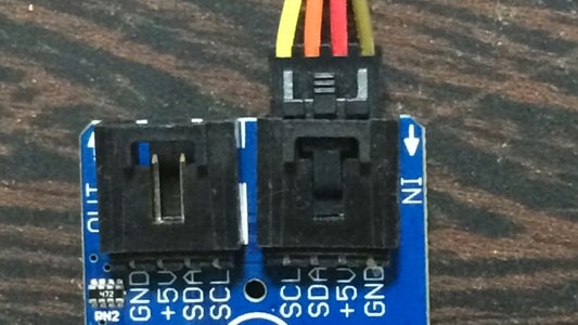

Then connect the one end of I2C cable to SI7006-A20 sensor and the other end to the I2C shield.
Connections are shown in the picture above.
