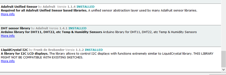

  • Arduino IDE (how to install libraries will be explained in the next steps)
  • Library: LiquidCrystal I2C (by Frank de Brabander)
  • Library: Adafruit Unified Sensor (by Adafruit)
  • Library: DHT Sensor library (by Adafruit)
  • The file attached in the following steps

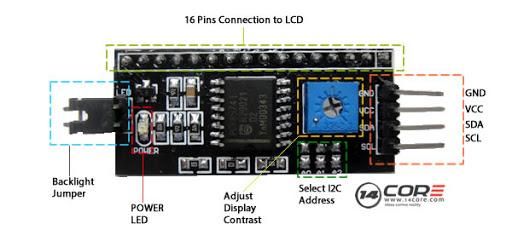

LCD1602 16x2 I2C (PCF8574 adapter board):
Any LCD screen that you are familiar with would work since screens are screens, but for this tutorial, we will be using a 16x2 one! Also, be sure to get the I2C variant, since it reduces the jumper cables needed from 20~ to 8~, which is first of all cheaper, and secondly easier to manage, and thirdly less of a nightmare to program. Get yourself a fancy colored one or like me the basic green one. Via the Nano, we will "write" things to display!

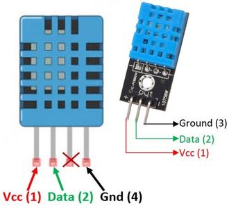

DHT11 Temperature and humidity sensor:
To be fair, the DHT11 is a little less accurate and has bigger offsets, but it's 5x as cheap as the DHT22! At the time of writing this, it cost me 2.5$ for 6 units, and 1x DHT22 costs 2.5$, and for future purposes, it's perfect to use the DHT11. This thing will send data to the Nano, the nano will process it and you can easily write it to the LCD

  1. DHT11 VCC -> Nano 3.3v
  2. DHT11 DATA -> Nano D2
  3. DHT11 GND -> common ground
  4. LCD VCC -> Nano 5v
  5. LCD SDA -> Nano A4
  6. LCD SCL -> Nano A5
  7. LCD GND -> common ground

Open the IDE and install the libraries seen in the screenshot!
