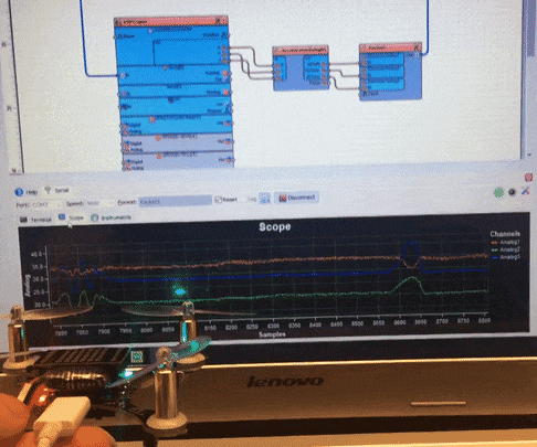

In Visuino, click on the Scope tab, select serial port, and click on the Connect button (Picture 3)
You should see the data from the sensor plotted on the scope(Picture 4)
If you cover the Photoresistor, you will notice that the value is increasing, and if you point it to light, it is decreasing. The reason is that the Photoresistor in this module has been connected to ground as you will see in the next step.
