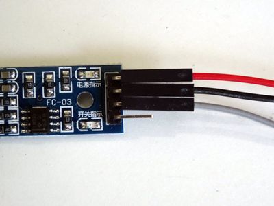

Step 2: Connect the Optocoupler to the Arduino Board
- Connect Power(Red wire), and Ground(Black wire) to the Optocoupler Module (Picture 1 and 2)
- Connect Data(Gray wire) to the digital pin of the Optocoupler Module (Picture 1 and 2)
