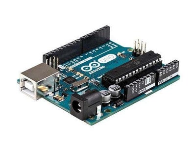

- Arduino UNO (or any other Arduino)

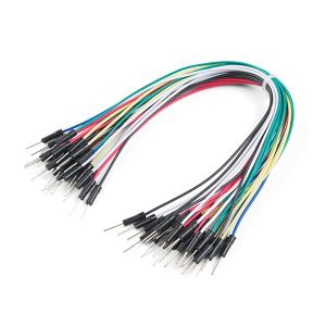

- Jumper wires

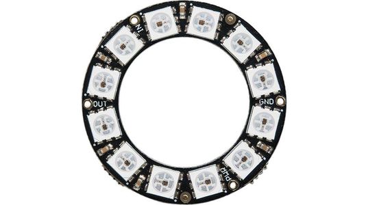

Step 3: The Circuit
- Connect LED Ring pin [VCC] to Arduino pin [+5V]
- Connect LED Ring pin [GND] to Arduino pin [GND]
- Connect LED Ring pin [IN] or (DI) to Arduino digital pin [6]

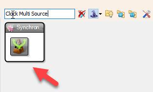

- Add "Random Clock Generator" component
- Add "Clock Multi Source" component

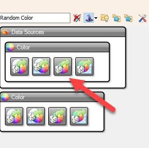

- Add "Random Color" component

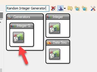

- Add "Random Integer Generator" component

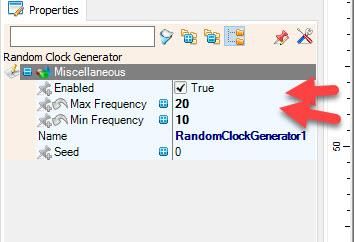

- Select "RandomClockGenerator1" and in the properties window set "Max Frequency" to 20 and "Min Frequency" to 10

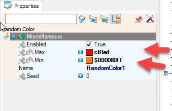

- Select "RandomColor1" and in the properties window set "Max" to clRed and "Min" to $000080FF <<Orange

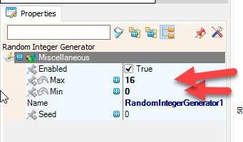

- Select "RandomIntegerGenerator1" and in the properties set "Max" to 16 and "Min" to 0
Note if you are using a LED Ring with more or less then 16 LEDs then replace the number 16 with your number of LEDs

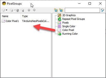

- Double click on the "NeoPixels1" and in the "PixelGroups" window drag "Color Pixel" to the left
- On the left side of the "PixelGroups" window then select "Color Pixel1" and in the properties window set "Count Pixels" to 12 or 16 (Depends on how many LED your LED ring is having)
- Close the "PixelGroups" window

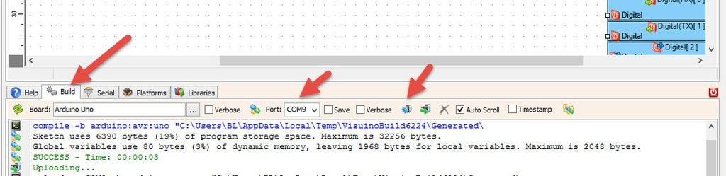

Step 8: Generate, Compile, and Upload the Arduino Code
In Visuino, at the bottom click on the "Build" Tab, make sure the correct port is selected, then click on the "Compile/Build and Upload" button.
